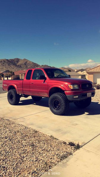

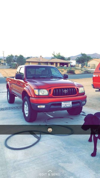

    Hey guys turning this into a build thread as of 2/14/17:). Basically a thread of my up and coming build and questions and bs and getting help from you guys. These are my first mods to my truck so bear with me I'm going to need a little help:). Excited for The process !
    I'm 18, graduated last year. Dad helped me get a Implulse Red 2004 Tacoma Extended Cab Prerunner 3.4L for my 18th birthday as long as I paid for half in May 2016. Got a job after high school saved all my money to build this thing to mob;)
    Pics to come!!!!!
    Suspension
    Icon 2.5 ET coilovers (2" of thread exposed)
    Camburg UCAs
    Toytec adjustable lift shackles set at 2"

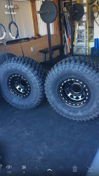

    Tires/Wheels
    Hankook MTs 33x12.50x15
    Pro Comp 252 15x8
    Bora .75 spacers up Front
    Performance
    Flow master 40
    Mods to Come:
    rear shocks???
    Bamf Sliders
    All-Pro Baja bumper
    Leaf pack:(
    Anyway, stoked to be apart of the community and have all you guys to help me out with any questions I have you guys rock! Don't worry pics to come!!

    Not sure about you're setup, but I'm running 285/75/16s on a 2.5" lift. My tires in standard measurements are 32.7 x 11.2. I rub the washer bottle plastic when making a u-turn. I had to do the pinch weld flattening mod and trim the bumper about a 1/2 inch. All I can say is trial and error. Good luck!

    I think mine are adjusted to about 2.5" with 33/12.5" tires. I don't know the exact amount since my truck had a spacer lift on it when i bought it. I have a 3 leaf 1.5" AAL in the rear so i just adjusted to CO's so that they sat level with the rear. My wheels have the same back space as yours and I did the Pinch weld mod (beating) for clearance. I haven't had any rubbing issues yet; I'm also not fully stuffing the tires either though. The UCA's you have should give you some positive caster to help keep your tires off of the fenders a bit more.

    You have any trouble fitting 15" wheels?

    They fit fine without any issues. It's mostly just steel wheels that have some issues with fitting over the brake calipers
