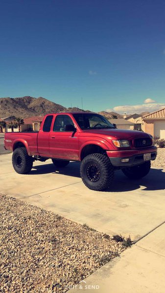

    @NightProwler how high off the ground are you ground to fender wise in the front ...im around 40"
  8. Feb 26, 2017 at 2:07 AM
    #128
    NightProwler
    NightProwler Well-Known Member
    Nov 12, 2013
    #116470
    3,491
    Harlan
    Maricopa, Az
    '01 Prerunner, '16 trd4x4, '03 cbr954rr, '03 rc51
    I'll have to remeasure as I'm sure my Eibachs have settled, only a tiny bit I bet, lol but last I measured it was 39". So you're probably a tad higher than 3" lift rn... That seems pretty high. Ha. Even for coilovers.. You'll have to let me know how she rides! I considered going c/o's. But Idk.. Not really a fan, for my needs anyways.
  9. Feb 26, 2017 at 8:28 AM
    #129
    kylevanhulten18
    kylevanhulten18 [OP] Well-Known Member
    Dec 2, 2016
    #203889
    313

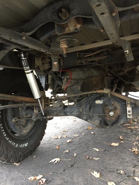

    Yea dude I'm pretty fucking high the max height was like 2.3 and I'm right at 2 inches of thread. That lift shackle I put in the back is badass though! And simple

    Truck looks awesome man. I like the color matching too!:thumbsup:

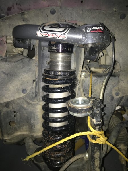

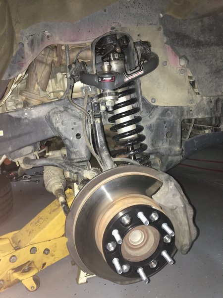

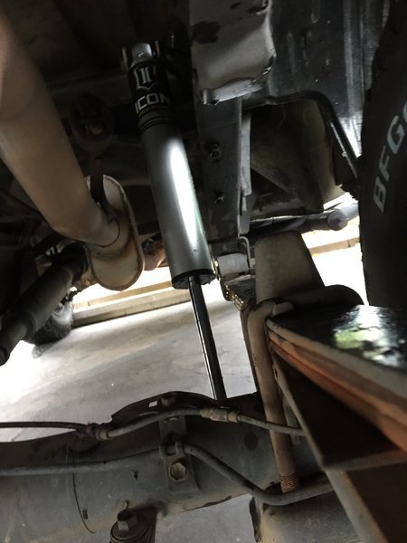

    The ride seems so stiff just went a couple miles to the store... haven't trimmed pinch weld yet only place I'm rubbing so far...besides maybe a little on the frame. I think the rear shocks are bottoming out from the 2" shackle not sure Though.. anybody else running icon coils at 2 inches of exposed thread ??
  14. Feb 26, 2017 at 6:03 PM
    #134
    kylevanhulten18
    Dec 2, 2016
    #203889
    313
    Maybe I cranked em too much... just need a better rear setup. Is that why it's so stiff?? Stock leafs and stock shocks

    I have mine set at 2.125" of exposed threads on the passenger's side and 2.25" on the driver's side. I'm only running 265/75/16's though. I also have Icon 2.0 smooth body rear shocks that are good for 0-3" and a 1.5" AAL. I had my fronts re valved at @Downsouth Motorsports and had them change the low speed valving so it's a lot softer. Well worth it IMO. At higher speeds the ride was fine and now the ride is fine at high & low speeds. Very happy now!

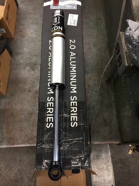

    Hmm some rear shocks might be my next investment...how do you like the icons??

    They're the non resis. But I couldn't pass them up. I got them in a group buy on here from off road warehouse and saved $75. They mounted right up to the stock location and ride and handle just fine. I eventually want to do a shock re location and I should've got a taller shock w/ more travel but at the time didn't have the shock re location idea in my head yet. No complaints here. I also have a Flowmaster 40 on my 3.4 Tacoma DC. I love the sound!

    Nice! Yea might go with those... ride just feels stiff right now. The front is okay I see a ton of people run them with 2" of thread .

    Give it a week or two and they should settle. But I still had a stiff ride after a month. So that's why I had them re valved. They're usually generically valved straight from Icon to the vendor off the shelf unless asked otherwise. Good luck man!
