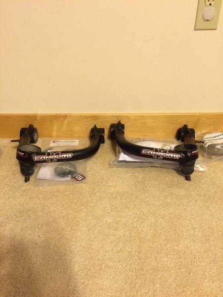

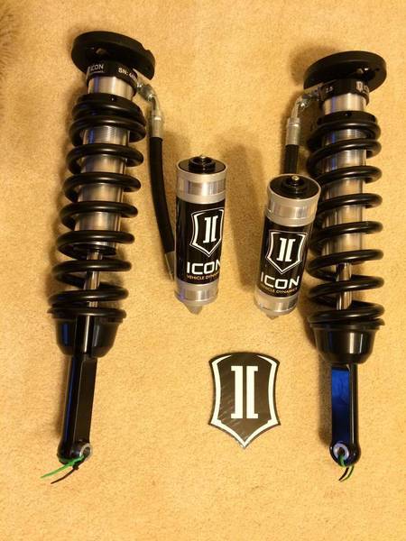

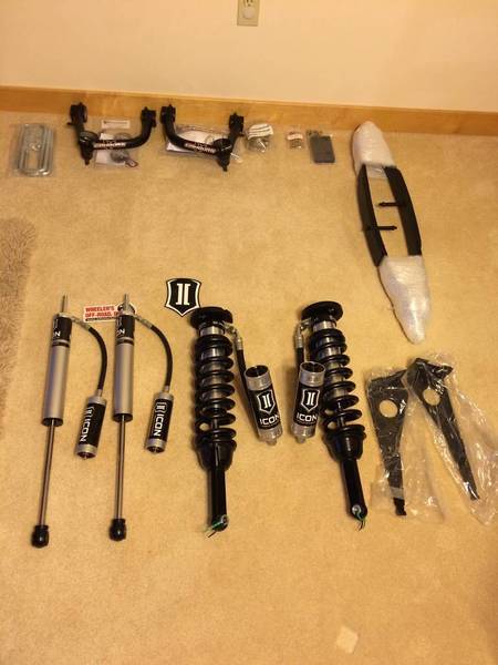

    I Finally was able to get my system together!! cant wait to put it on this weekend. Tires and wheels are going to have to wait since shipping to AK is $850-$900 [​IMG]
    UCA: Camburg with MOOG balljoints and UCA balljoint cover kit
    Front: ICON 2.5 extended travel with remote resi's
    Rear: ICON 2.0 remote resi's
    Spring pack: Wheelers 3 leaf progressive HD pack
    Misc: swaybar relocate, OME driveline packer, extended U-bolt kit.
    Special thanks to YotaDan at Wheelers for all of his assistance in helping me put this system together and the exceptional customer service!!!
