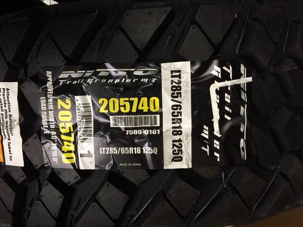

    Tires are here :kona::bananadance::goingcrazy::goingcrazy:

    Now waiting on these to come on the barge,,,,,,

    Love those how much were those? Think your gonna have any rubbing issues at all?
