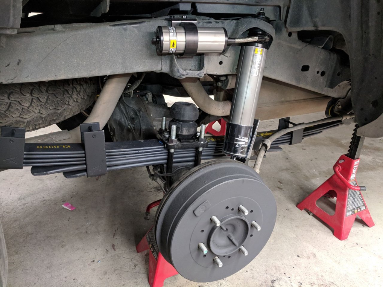

    Currently have Timbren bump stops and u-bolt flip (that is my truck in the 1st picture) and would like to go with Icon's Hydro bumps. The problem is the hydro bump bracket and remote reservoir are in the same place.
    1) Would it be possible to piggy back the remote resi onto the strut? Has anyone done this or has recommendations to do this? Hose clamps? OME makes a clamp, but not for Tacoma setup. (3rd pic)
    2) If the tubes are the same diameter and no clearance issues (tires/brackets)...anyone think it wouldn't work?
    UPDATE/IDEA: What would happen if we switched the brackets Driver<->Passenger and mounted to the inside of the frame rail where there is a lot more open space? Would just need to either weld it in or find a way to bolt the top of the bracket.

    It seems to me you would want to get the resi lines extended in order to achieve this and then mount the bracket further out. Do you do a lot of fast driving to where you need hydro bumps? I ask as I didn't go to hydro bumps until I went LT in the rear with my truck, but with a mid travel SUA the stock bumps held up pretty decent.

    I think getting the resi body brackets to mount the cans parallel to the shock makes sense. Cheap, no extending the lines, and it can be clean and out of the way.

    Update: Talked to ARB USA and they were able to find a clamp that will work from another fitment kit and barring anything major, this should work out! If ANYONE needs (highly doubtful) the info ...
    Part#: VM20010001SP
    Description: SP:RESI CLAMP ASSY

    Would the reservoir go outward (away form the axle housing) or inward (towards the axle housing)?
    At full compression real-estate in the wheel well is hard to come by and the axle housing/shock tabs crashing into a stationary reservoir is very unforgiving.

    This was my concern as well. The banjos felt more at home with the reservoir mounted towards the axle. Tried mounting it outwards, but the hose was flexing so much I was worried about it crimping. Flipped it around and it's a better/more relaxed fit. Pics are at nearly full compression and there was plenty of space since the reservoir is 2.5" and more narrow than the shock body at 3". It was rotated out away from the frame to "split the difference" of the free space on either side.
