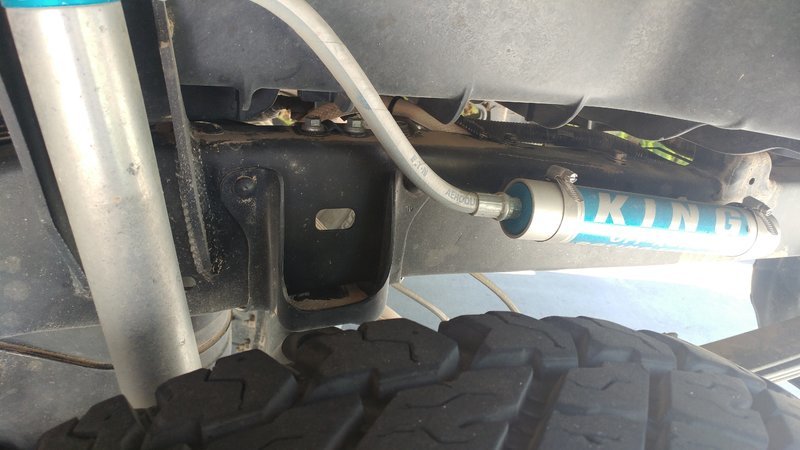

    I've also seen some guys notch the bump stop strike plate mounts to relieve some potential rubbing through on the hose. This happens when you don't leave enough slack in the line when mounting the resi. Just to add to the "notching" list.

    I could see that being an issue. However, easy fix: longer shocks. Get that hose up and outta the way. :rofl:

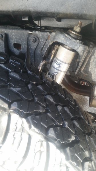

    I like how the fox resi's are designed. The shorter the hose the better. Everything is nice and compact with less chance of a failure. Just my opinion
