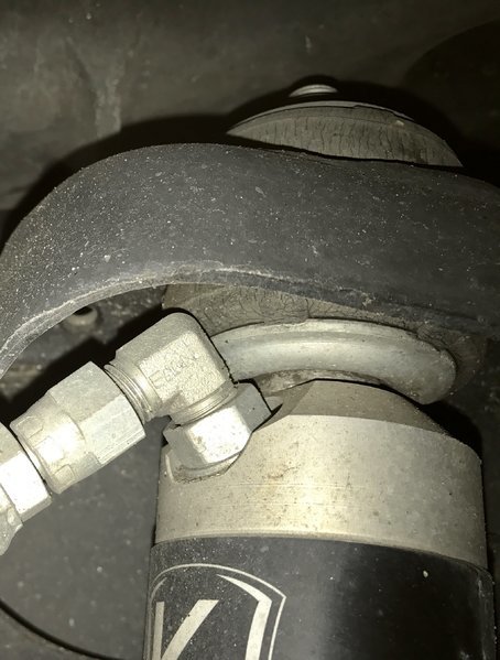

    It's not the hose that rubbed through. Look at the original picture he posted. The reservoir is most likely mounted too far away pulling the shock/fitting in towards the frame. When the suspension cycles it's causing the fitting to hit the mount and loosen it. Some extra slack when mounting the reservoir to keep it away from the mount is all that's needed. It's not that complicated.
    Says shocks were installed end of October, started leaking Novemberish and hasn't touched, adjusted, emailed or tried to fix the problem until now.

    You can see where the oil is leaking out of the fitting and "washing" the shock body as it runs down.................
