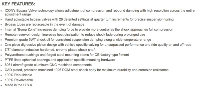

    In fact, it says "OE factory type fitment" which is even more vague than I thought at first

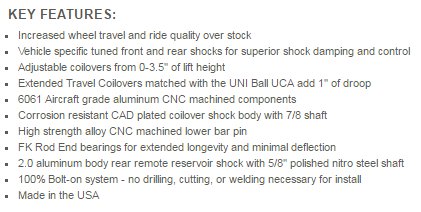

    Problem is at this very second their website proudly declares "no cutting" (or drilling for that matter, which is also false for the remote resis which do require drilling the frame).
    Again, I don't have any real issue with their new instructions. Actually glad they go out of their way to highlight the issue in the instructions to prevent failures. But they need to change their advertising copy and they should demonstrate goodwill to folks like the OP who were caught in the middle of the change to the instructions.

    I stand corrected, that is a different kit than what I was looking at at first. However, to be fair you wouldnt have to cut anything for the INSTALL, just to be able to safely DRIVE it :rofl:

    haha ok I guess that fine print is there...sure you can install but you can't use.
