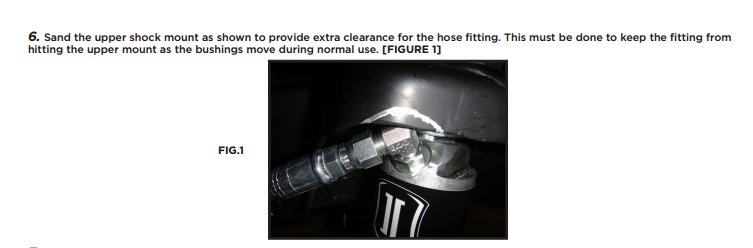

    To be fair, their current instructions which indicate to do some minor grinding are just fine as far as I'm concerned.
    One issue is their advertising copy on their website is well out of date. And as you discovered inconsistent across kits even those which contain the same parts that need the grinding.

    You don't need to cut/grind/trim the mount if whoever is doing the install takes the time to mount the reservoir in the correct position.
    Read it all four times.
    Most likely the reason for the instruction change is because most people aren't competent enough to work on vehicles. Sad truth.
    What's easier? Try to explain suspension geometry, mechanics and why precise mounting is critical or having the customer just grind a minute amount of material so it's a non-issue?

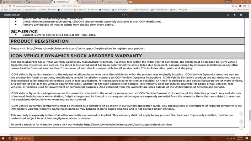

    Ehh? Not sure what's going on. I posted this before but I'll post it again, here is Icon's warranty on Tacoma 2.0 Shocks
    It specifically states that the shocks aren't race car parts. :D

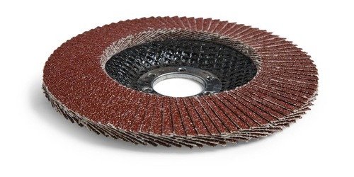

    you know there is more options then just hand sanding right? ever heard of a flap wheel? I use them all the time, and to remove that material it would be about 30sec with the flap disk.
