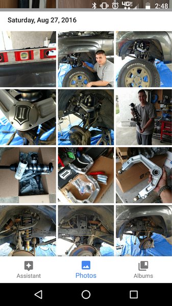

    I think my suspension was installed the end of October

    Actually I was super off. The install of my suspension was done August 27th 10:28am per my Google photo

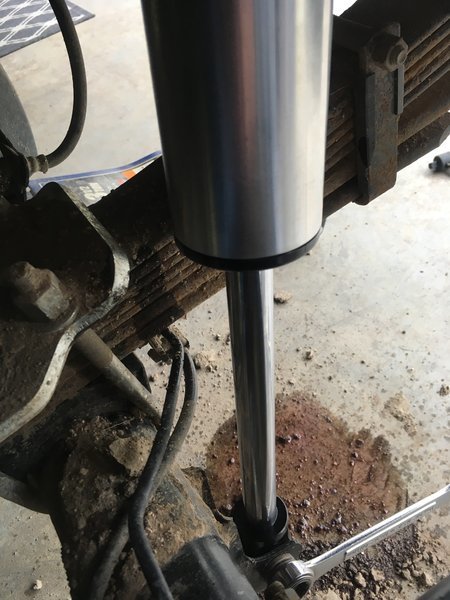

    Word to the wise with Icon resis: check the fittings before you install. One of my brand new 2.5s had a finger-tight fitting out of the box. This is what it looked like on the truck on install day. Yep, that is a puddle of shock oil. Put my non-resi 2.0s back on temporarily. Not good, Icon.

    Any info from Icon on how notching the bucket would have prevented your leaks?

    No they just sent me the pics

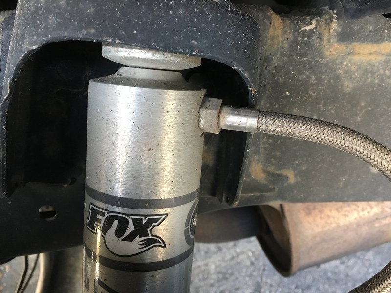

    Apparently you have to notch it so the resi fittings wont rub. Cut your truck for a stock replacement shock? I'm glad I went FOX. Again, seems like ICON should have just resolved the problem and have a happy customer.

    I'd ask for an explanation. Share this pic with them if they don't provide an adequate responses and let them know TacomaWorld is very curious why they seem to have some recurring QC issues and shitty customer service :boink:

    6. Sand the upper shock mount as shown to provide extra clearance for the hose fitting. This must be done to keep the fitting from hitting the upper mount as the bushings move during normal use.
    7. The hose must exit as pictured. [FIGURE 2] Allowing the reservoir hose to exit differently OR over tightening of the stem bushing lock nut will cause the reservoir fitting to collide into the frame. [FIGURE 3] displays contact of the reservoir fitting and the frame when the shock is installed incorrectly.
    If the fittings made contact with the shock mount, makes sense that they wouldn't warranty that. The instructions are pretty clear.

    I guess this is not an issue with King or Fox because they use a different fitting on the hose.

    I installed a set of ICONs a little over a year ago and did not like how the fitting was close to the stock shock bracket. I trimmed it and it was no big deal. In January I installed another set and when I looked at the instructions and was amazed that it was specified to notch it. Notch took about 3 seconds and I never had to worry about it.
