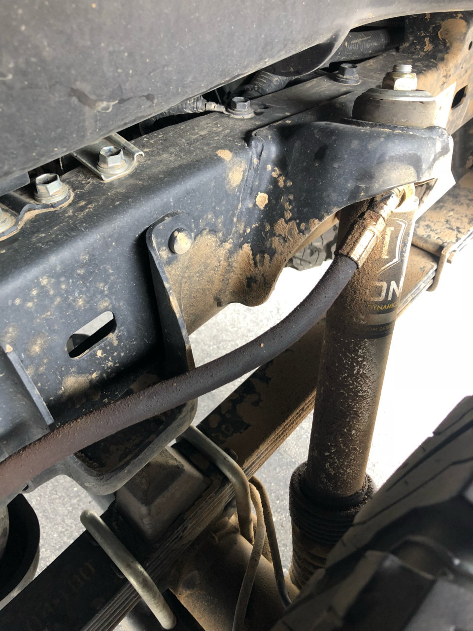

    my second blown resi?

    No notch, and there's a clear contact line on the resi fitting.

    Also the top nut is too tight. Instructions say to tighten until flush with threaded section.

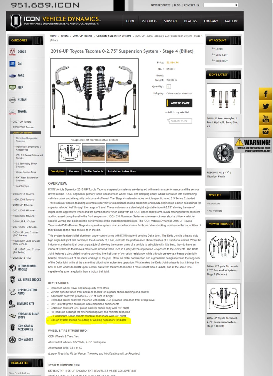

    I may be a little late to this thread but they are contradicting themselves on what's in the instructions and what they advertise.

    Honestly, the grinding isn't even probably 100 percent necessary. The major issue is people cranking down on the top nut instead of leaving it flush with the stem. I sanded mine down just in case and then took pictures and sent them to Icon to make sure that it looked ok. It's been a year, lots of desert trails, no leaks, no issues.
    I'm not an Icon fanboy. They have been really easy to get a hold of though. If the semi-digressive valving or a little bit of grinding isn't what you're feeling, then buy a set from the other major players.

    I missed this thread but it amazes me how high the expectation is for companies to replace a unit that was not a manufacturer defect but an installation error.
    Some of the pics you can even see where the shock bucket makes contact and the manufacturer is blamed and expected to eat the cost?

    My argument is why did they not design the shock resi to be a little farther apart from the bucket...like ALL of their competition does? I don't recall many folks having leaking shocks from king...but from the ones that I have seen, well king took care of them for instance. I think fox is pretty good about that too.
    At the end of the day if your warranty process dictates that you have to trim your shock bucket in order to receive a warranty should there be a leak...well then why advertise that it is solely bolt on? I guess you can still bolt it on, but without modifying your frame, you can kiss the warranty good bye for support.
