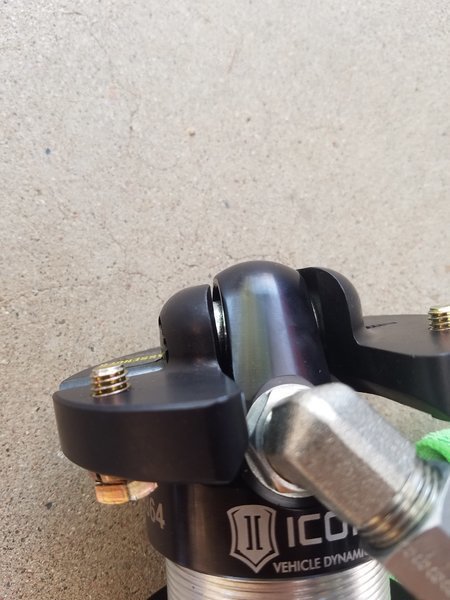

    "Icons new top hat design is up to par with King/fox" just lol.....

    I don't know if I'd say one top hat is better than the other. I have seen pictures of broken Icon top hats yes. In my opinion that is the result of buying an extend travel coil over and just tossing it in. In that I mean you haven't read the specifications on the coil over enough notice that the collapsed length is longer than stock and will bottom out prior to hitting your bump stops. Then said user goes out, bottoms the coil over out and those stresses need to go somewhere. The solution was a longer bump stop, now you have a broken top hat. I'd rather a broken top hat than bent shock buckets or mangle control arm mounts.

    Bro I broke the "new top hat design". Madison at icon tech support said, "we don't offer a revised top hat design"...when I asked a month or so ago about the top hat they were sending me.
