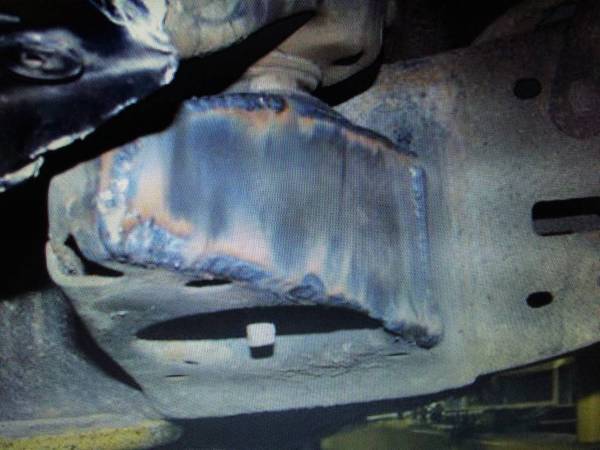

    If I had known then what I know now I would have considered lots of different sliders. I'm kinda fond of BAMF since I have his behind-the-grill light bar holder and it's pretty awesome craftsmanship. But at the time I didn't want to weld or drill my frame which took me to Avid. I will say that the welds/bends, etc. all appear really nice on the Avids. I'm very happy with them and they ought to fit my needs perfectly. I toyed with just buying an entirely new set of sliders, but Avid came through with the required parts, wrapped them up and shipped them to me for something like $50. I was actually stunned how cheap it was.
    I might take care of the CMC on Friday too. Is there any magic to that operation?

    Nope just approximate the section you need to crop out to give you the most room for your tires. crop that section out, (recommend using a plasma cutter), trace out your cut, I used cardboard, cut your blank, and weld it in. watch the heat and stitch weld so you don't mess up your rubber mount. took a couple hours overall but not too bad.
