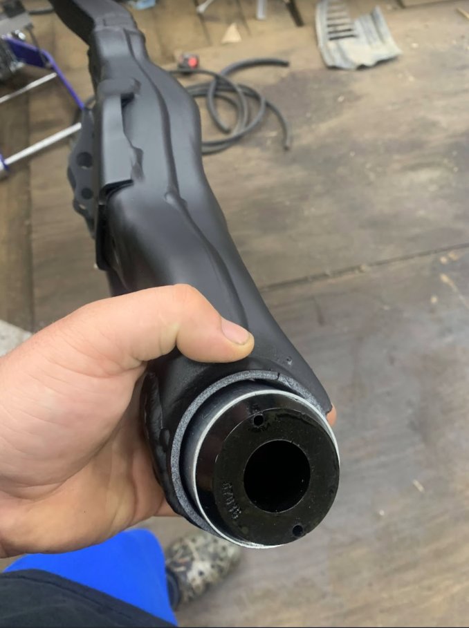

    it’s hardly a minor scratch. It’s practically progressively gouging the body of the LCA, not to mention seriously reducing the steering radius and how the misplaced tabs are grinding on the body of the bracket.
    I’m not buying it. That’s a major screw up either way. I was expecting a better answer from Icon. Not even a note or disclosure of this issue was on the website. This is basically saying “we designed something half-assed, now make it work for yourself”.

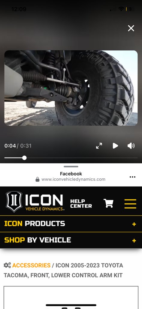

    Icon's photos on the product page show the factory steering stop installed backwards (i.e. swapped left and right). This is probably how Icon tested the LCAs off road:
    And get spindle gussets if you decide to go over terrain the Icons were designed for. Most people reinforce or upgrade the spindles before splurging on upgraded stock-length LCAs.

    Sharp eye and good observation, @3JOH22A . That's what @TireFire suggested as well. This significant detail is not in the installation instructions though, and photos in the installation instructions do not show the brackets being reversed.

    Basically, it's either that (unethical business conduct), a design flaw that requires an easy fix, a failure to update instructions (if switching brackets is required to reverse the steering stops is the issue). None of which Icon is willing address.
    They're basically selling an expensive unit to 2nd gen owners that will get damaged upon installation, damage the truck's steering stop brackets, and create further issues....

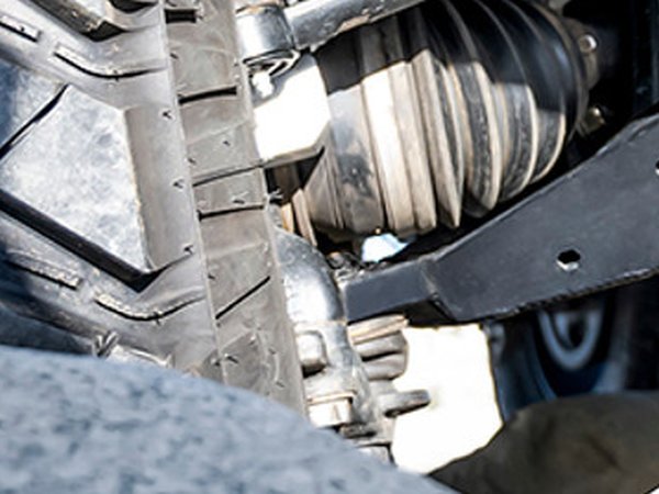

    So I found this other photo on Icons site clear as day showing they swapped sides on that steering stop to have them facing backwards so the stop hits the back of the arm, not the front. I do have the S2 setup installed on my truck, so wondering if this will work for me. I think I’m gonna try this route

    I looked at all those photos, as did other folks, and honestly, the photo isn't clear enough to me. The instructions do not mention anything about reversing the stops and the photos in the instructions don't show them reversed either. Still working on this with my installer, we're waiting for some other parts to arrive. I'll keep this threaded updated once I have a solution for my situation.
    We'll either:
    1. swap the stops (if that works),
    2. Modify the LCA with the stop tab relocated to the front, or
    3. Just scrap it out and go with another LCA brand is known to work with the 2nd gen.
