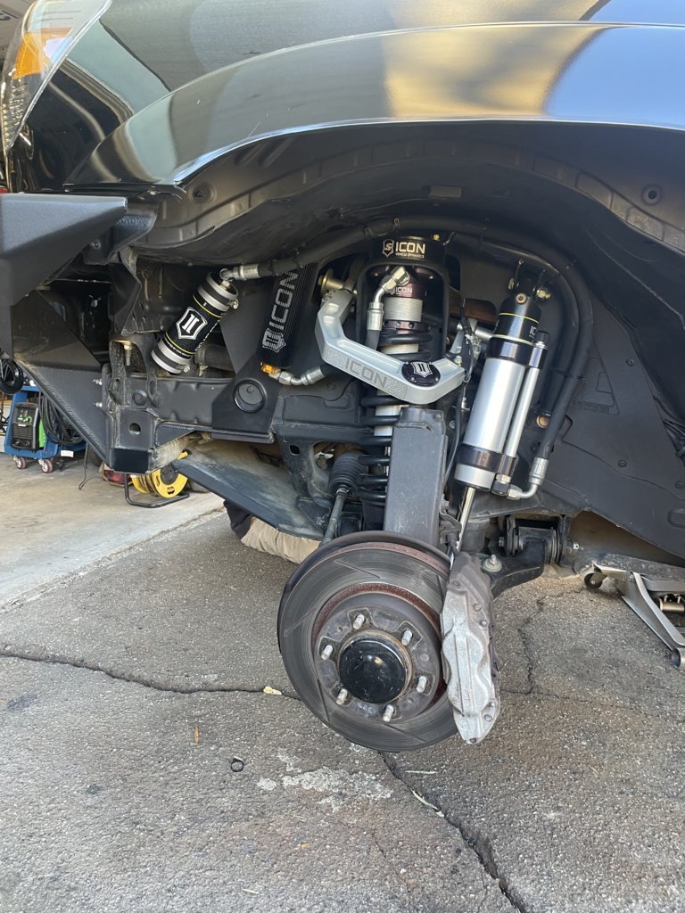

    The fun has begun

    It’s official, the steering stops CAN NOT be flipped. Definitely not gonna work. Pics coming soon

    So the steering stop issue…. It appears to me that the LCAs were designed this way- to have the extra block on the back of the arm and have the stock steering stop just contact the leading edge of the LCA. The block on the back contacts the knuckle and acts as a stop that way while the front just gouges away at the powder coat. Cutting the steering stops off the stock ball joint mounts wouldn’t really net you much more steering angle since the block at the back of the arm would still contact the knuckle at full lock. We did try flipping the LBJ mounts side to side to have the steering stops at the back of the arms and it was an obvious no go. First the stop doesn’t line up with the block on the control arm and it would just barely catch if at all. Second, if they did make contact, your steering would be severely limited. I’m talking 8-point u-turns, limited. That was my initial theory with stacking steering stops, but we had to check to be sure.
    1: I confirmed with several third gens and the steering stop issue identical to second gens. So they should work the same on third gens.
    2: TC arms will work with icon but they can’t accommodate Icons secondary shock setup without some cutting and welding/ fabrication.
    Overall my impression of these is that they are not a direct bolt on part. We did have to do a little grinding and adjust the pressed in bushings by spreading them back out a little. They came pressed in too deep from the factory which caused a fitment issue where they were too narrow overall. It’s an easy (although tedious) fix if you got the tools, but would be full-stop if you’re a casual weekend wrench. QC was lacking a little as these looked like they had been tossed around a bit- scratches and scuffs in the powder coat which isn’t a big deal to me or @Georgeth1022 since he plans on using these as intended, but for someone that wants pretty parts on their truck, they would be disappointed. I’m not saying don’t buy them, but expect some work to get them on. I haven’t heard these types of issues with TC or BTF LCAs.

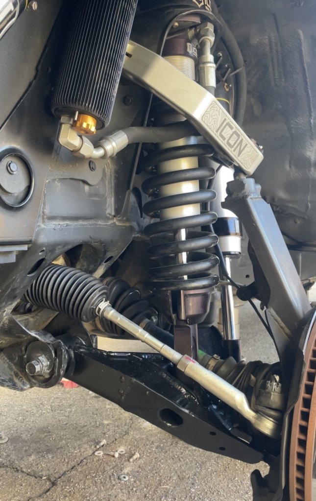

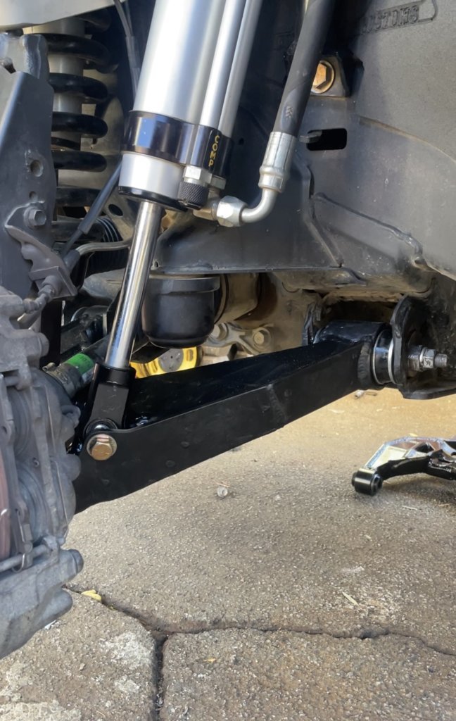

    The end result

  19. Nov 16, 2024 at 8:30 PM

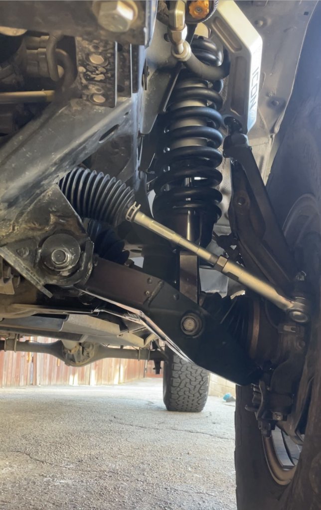

    Few more shots

    Pictures of the steering stops:
    stock orientation, full lock:
    stock orientation, neutral setting:IMG_0104.jpg
    Swapped LBJ mounts. Notice how close the steering stops is on the LBJ mount to the block on the LCA. Not much turning radius there IMG_0103.jpg
