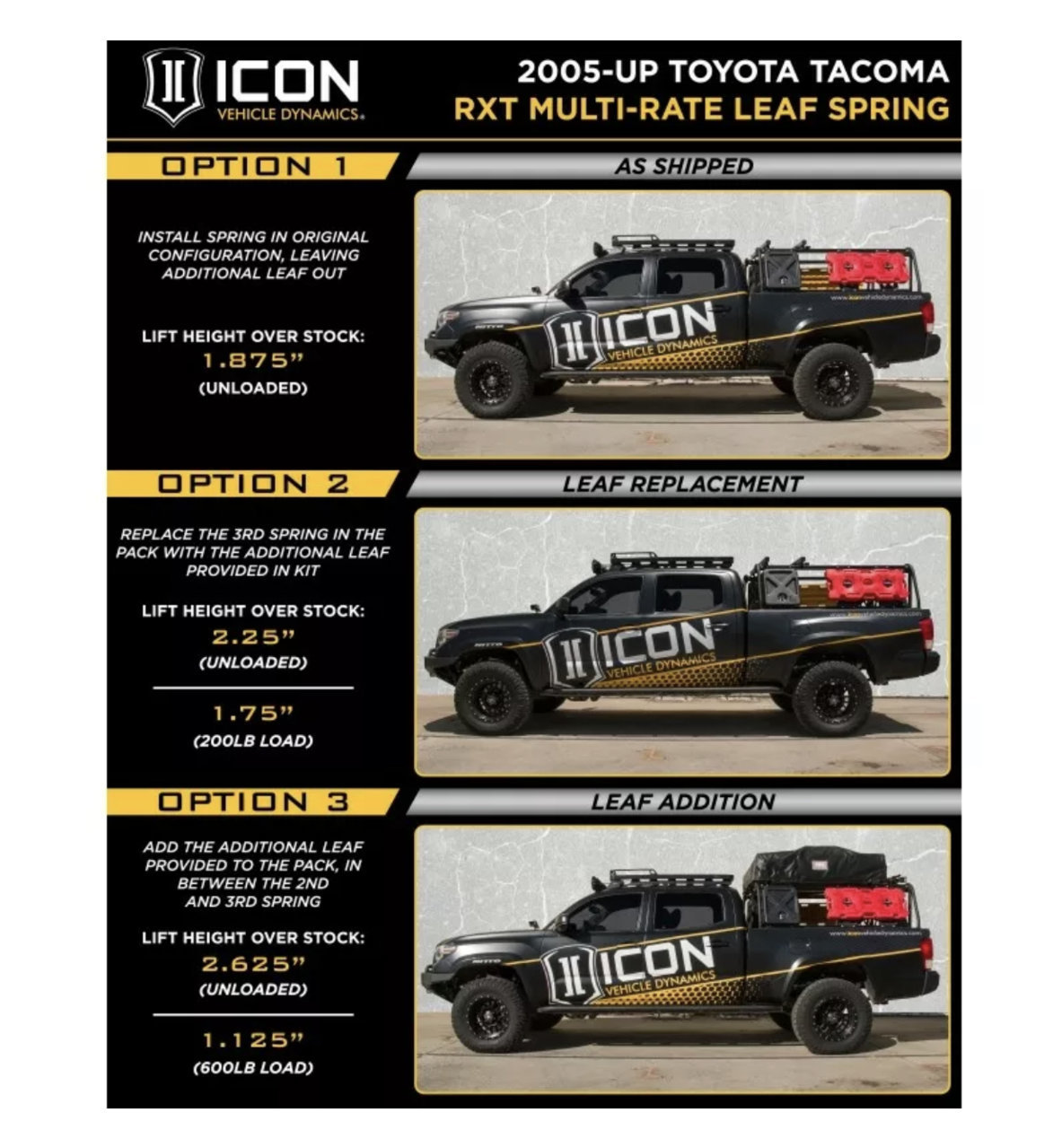

    Hello so i bought this leaf springs online. I was wondering How much do they lift since my rear shocks are the 2.5 fox shocks with 0-1.5 lift. I dont have any weight on my back so Im going for option one that is 1.875 but i dont really know what that means. If someone could help me out and explain to me i will be so thankful.

    That means 1.875” higher than stock.
