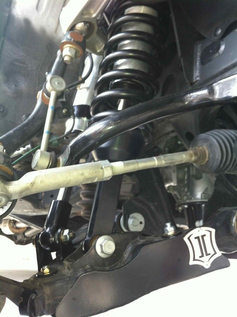

    here's some pics for you guys. saw this set up in person today at the expo. looks great (this was on a 2012 tacoma)
    and 2 more new products from icon. bolt on hydro bumps and OE replacement rear bypass shocks

    Hmm Un sure on the skid. I want second shock but I like how the bamf skid protects the lca better.

    why did they add another stock bump stop under the original one? somethings goofy
    The bamf skid is of poor design IMHO. That steel that protects the "cam" will only bend under any impact and cause more damage most likely + his skids have poor tolerances and are spaced back 1/2" - 3/4" from the LCA or at least the first 70 he made in his group buy were. The first rock you touch shears the mounting bolts because of the huge gap. IMHO the LCA skid should have super tight tolerances so it can be welded to the LCA for superior protection. This will also allow the bolt on guys to not sheer mounting bolts should they impact anything because the force will be directed into the LCA not rest solely on the bolts holding it.
    I would bet my paycheck the Icon skid would far outlast a Bamf skid any day unless the Bamf design has been changed. You can clearly see the Icon skid is flush tot he LCA.

    I thought about what you said when you Pmed me about it and I'm leaving the skids the way they are. I would much rather have the bolts as a failure point then the LCA It self. With over 200 sold and one "failure" and from ramming rocks at that something is bound to give. In this case it was the bolts and the alignment of his LCA's was still spot on so I feel they did their jobs. I myself would much rather replace a .25c carriage bolt then get the alignment redone. Yes everything has a failure point and putting skids on your truck does not turn it into a battering ram. Honestly if your bashing your LCA's into rocks you need to chose your lines better. I still feel my skids have the most coverage on the market today but thanks for the opinion.

    Honestly then i would just replace the LCA's all together no skids are going to protect you at high speeds like that the force will be transferred to the LCA anyway you look at it. I have been thinking of designing a replacement LCA for the mid travel guys i think TC has one for you guys don't they?

    His BAMF skids are made of 1/4 inch steel, it's takes a LOT of force to bend these things. The amount needed to wreck these skids would do serious damage to your truck regardless. There is nothing wrong with how he designed the cam bolt protection, if it gets bent back, the back of the plate would come in contact with the end of the cam bolt, that's it. If you managed to damage the cam bolt with the skid, chances are the amount of force needed to do that kind of damage would have rendered having a skid a moot point, it wouldn't have mattered anyway.
    Nothing is going to be perfect because when you armor one piece you then make another area the wink link.

    I know keeping loose tolerances makes for quicker production and less issues with fitment from customers but IMO I don't see any use for them if they aren't made to hit rocks without shearing bolts. If it can't take a hit whats the purpose of them? Bling?
    My TC skids have been on for almost 3 years and have bashed off of plenty of stuff including many rocks. Craig's BAMF LCA skids were highly "damaged" and falling off after one hard run.

    Not trying to argue here. I have seen his skids after one day on the trails. They were demolished. I sent Jerry a PM telling him what I though of the design and how I would fix it. I said I would keep my trap shut.
    Not until I just spoke to a member who purchased them and found out he never changed the design did I now speak up.
    No other LCA skid manufacture puts the LCA skids 1/2" from the LCA. It's simple physics. There is a reason all skids go flush to the OE members no matter what skid they are. If you want to relying on some thin grade 5 bolt to hold your skid on a 5k truck at speed hitting something have fun with that.
    Ill unsub now so you can all flame away. Just remember I tried to help everyone before you guys even knew of this issue and I told Jerry the ones he already sold could of been given spacers so theirs don't break.
