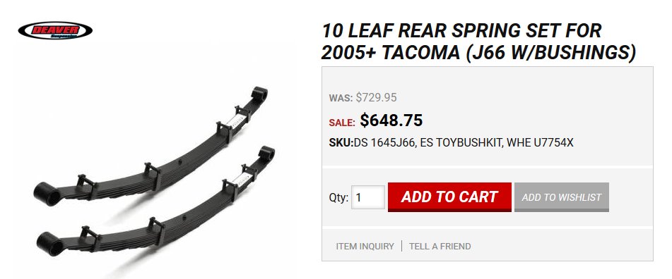

    Therefore, which leaf would you recommend for that use? HS offers Deaver single AAl, HS 3 leaf AAL, or Dakars?
    Which would be considered "more leaves"?

    Deaver 10-leaf pack most likely. If you can find one with 12 that would be ideal. An AAL wont cut it for your purposes. The issue is that the combo of going fast AND carrying weight are essentially opposite ends of the spectrum for a leaf pack. If you want to go fast you typically want a softer pack to absorb hits and then droop back out quickly, and for carrying loads you obviously would want a stiffer pack to handle the weight. Using a light leaf pack to carry heavy loads leads to excess sway and using a heavy leaf pack for desert running will have you bouncing in the air off every woop. The best of both worlds is a progressive pack with lots of leaves so the entire leaf pack is pretty stiff but if you dont need the whole thing for the hit then only a few leaves will be used and they can rebound more quickly.

    Well informed..
    Am I expecting any rake with this setup?
