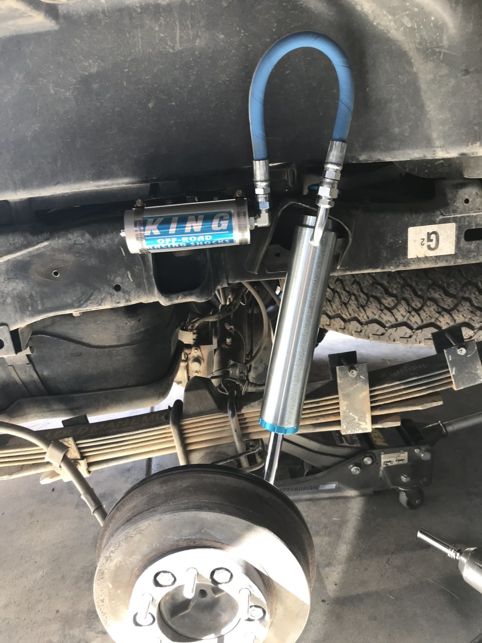

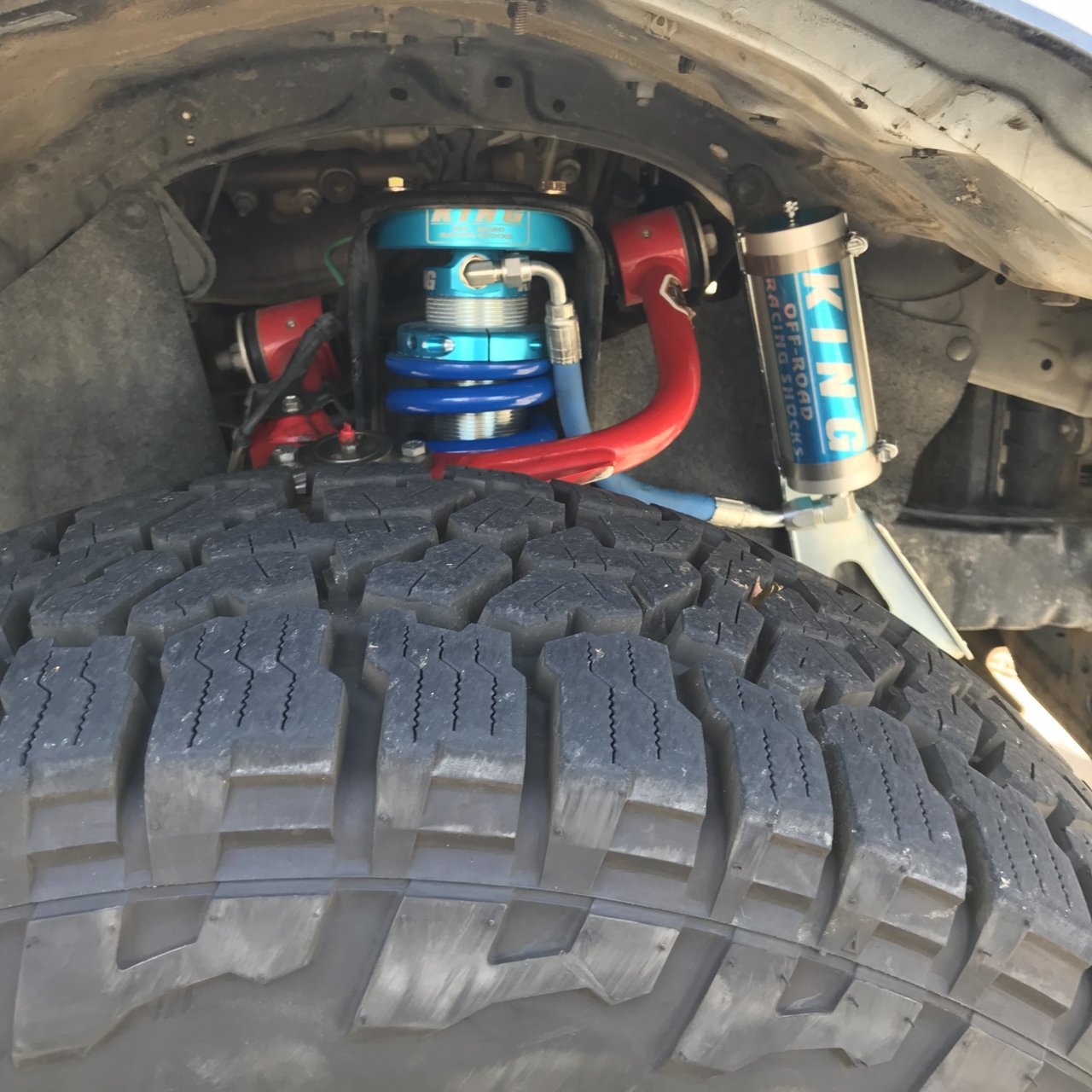

    Thanks for the tag!
    So I had icons w/ 650lb springs and in my opinion rode like crap at lower speeds , but the high speed stuff was fun. Over rocks it was unbearable. Not even a year later I made the switch to king. I will never look back. So much smoother on the street and highway & rides great and soft off-road! Plus to achieve a 3in lift I didn’t even have to adjust much preload (they come with a 14in spring) as for icon I had almost 2in of preload and was barely at a 2in lift. Honestly based off my experience I would not recommend icon unless you are going to be going 50mph+ every single time you hit the trails. If you have anymore questions just hmu or ask me on my Instagram: @carl_trd. I barely saw this right now.
    Also, if money is tight, I would save up for Kings, don’t do what I did and rush then have to spend more money replacing it for another brand. Just do it once and done. Oh and the whole adjuster thing is a little gimmick, hardly makes a difference. You will notice something but it’s not worth the extra $300 they charge. I had icons with CDC valve and it did not make a huge difference.
