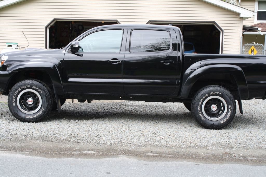

  19. May 15, 2016 at 11:41 AM
    #59
    bludweiaer
    bludweiaer Well-Known Member
    Jan 10, 2011
    #49016
    1,808
    pa
    2017 Pro DBL Cab,,2020 F3L Spyder...Polaris 800..
    avs rain guards,,,tyger auto tubesteps... stealth SR8's.265/70/17,ridge grapplers..shiftsense pro...
    IMG_4536_bc570b30acd482cb13b2994875b684e0e808b57a.jpg just washed and took this pic, ordering toyo at 2's soon to replace the coopers,, 10,000 miles on them they are over 1/2 worn down,,,,,,,,, you can see the rake,,

  20. May 15, 2016 at 12:07 PM
    #60
    TRDProBuddy
    TRDProBuddy Well-Known Member
    Jul 11, 2015
    #159220
    511
    MD (Kent Island)
    2015 TRD Pro (Inferno)
    Thanks for the picture, looks better than mine in the back. Mine looks like I am always have something in the bed. Though hard to see that it is 1 1/8" rake.
