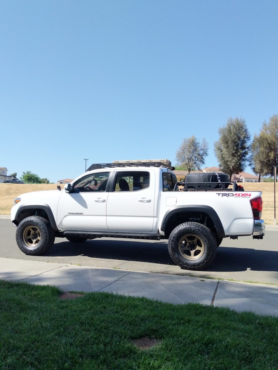

    PXL_20210507_231216497.jpgIcon 3-AAL with stock overload. There's about 200 lb of stuff in the bed. Not bad while I wait for stage 2 Deaver.
    71tattooguy and williams63 like this.

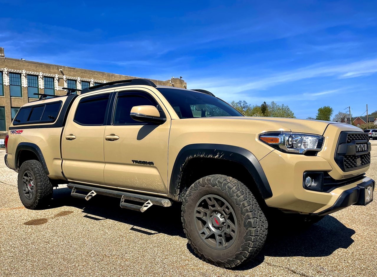

    Scott
    PA
    2019 Off Road Looooooooong Bed
    So ended up having the icon aal installed with the overload removed. No air bags. I wanted to leave the overload in but the place I took it to did it by the book, and since icon’s instructions call for removing the overload, that’s what they did. So far so good though.
    I had the front 5100s set on the 3rd notch, I think that was about 1.5” of lift for that setting. Ended up a little shy of icon’s advertised 1.5” of lift in the rear, but that’s probably expected due to the weight of the shell.
    Overall I’m happy with the result. So far, carrying heavier loads doesn’t seem to sag the rear as much as I thought it would without the overload in there. If the springs settle or soften significantly, I’ll add the overload back in
    The ride is good. Not much different then stock OR. Maybe a tad firmer, but not without absorbing bumps nicely.

    I had the same review when I was running an empty bed but after a little while that thing will squat. I would say it's a good set up if you don't carry any loads in the bed and a good temporary hold till you get full packs.
