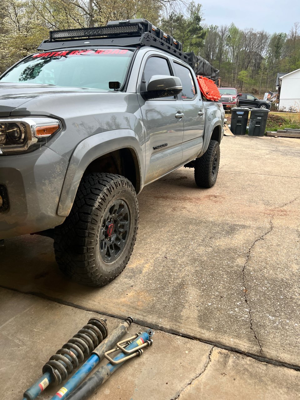

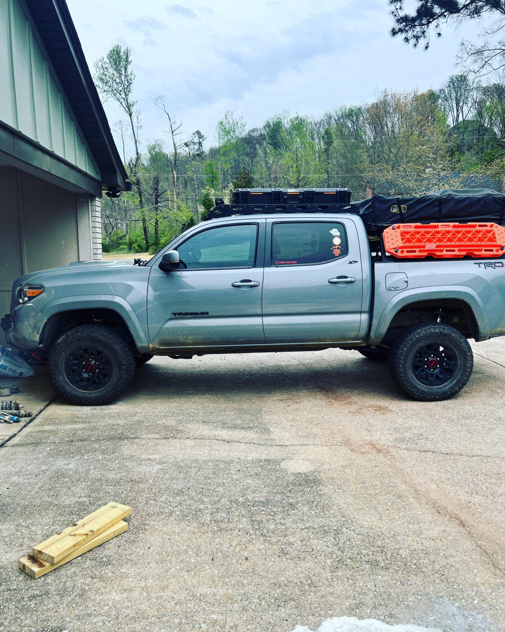

    Droz
    Droz [OP] FIDO
    Jun 16, 2021
    #368789
    74
    2021 Tacoma TRD Sport DCSB
    So I installed the full lift last weekend. Went pretty smooth considering I have never messed with a suspension before. A bit frustrating doing it by yourself. But I am happy with the results. Just got back from the alignment shop that specializes in off road vehicle alignments and all is good. I do have a few warning lights now about VSC and blind spot monitoring. I will take it to the dealer to get those reset. The pavement ride is better than the stock TRD suspension with the Hitachi shocks and leaf springs. I have not had it off road yet but next weekend we are headed to the DBBB in Kentucky and that will be a really good test. Overall I am very happy with my selections and the cost.

    gotoman1969
    gotoman1969 Well-Known Member
    May 30, 2018
    #254966
    7,007
    Steve
    San Antonio, TX United States
    2015 Silver Tacoma PreRunner
    3" ToyTec coilovers, JBA UCA's, Bilstein 5100's
    FYI. When you got to 33s you’ll more than likely need a CMC and either wheel spacers or new wheels as the factory wheels with that tire probably won’t clear the JBAs. Truck looks good.
