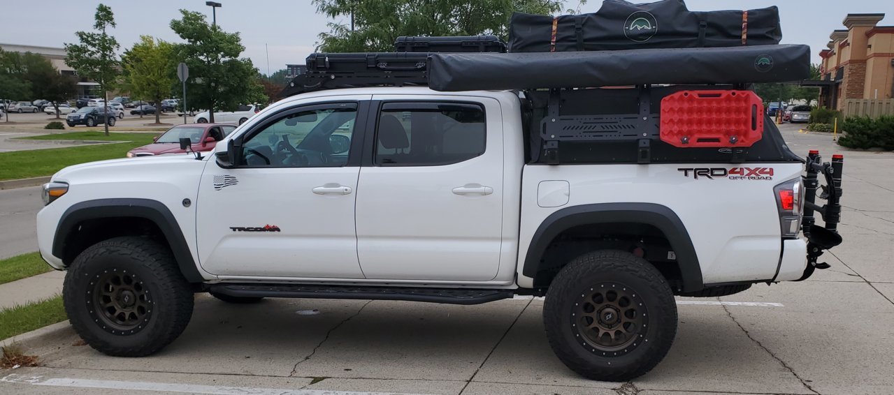

    Prinsu Rack, CBI Sliders, UpTop Truss Rack, Softtopper, TRD OEM 2" Lift, SCS Rims, Wildpeak tires, OVS RTT and 270 Awning, Off-Grid Engineering Dual Battery tray, Red-arc BCDC, Switch Pros Controller, cheap Amazon lights.
    It would NOT be harsh. I also have the TRD lift and did exactly what you want to do. Replaced the block and springs with Icon RXT on option 3 (And a 3 degree shim as long as I was in there). This is my "Pre" camping daily driver loadout. RTT, awning, rack, softopper. In the bed is a bed mat, Hy-Lift, full size traction boards. And misc stuff in the boxes. I estimate around 300 lbs. Rides very smooth and not harsh at all. Loaded for camping, and I can still hit the bump stops sometimes.
    EDIT: Forgot sliders, so probably closer to 400 lbs.
