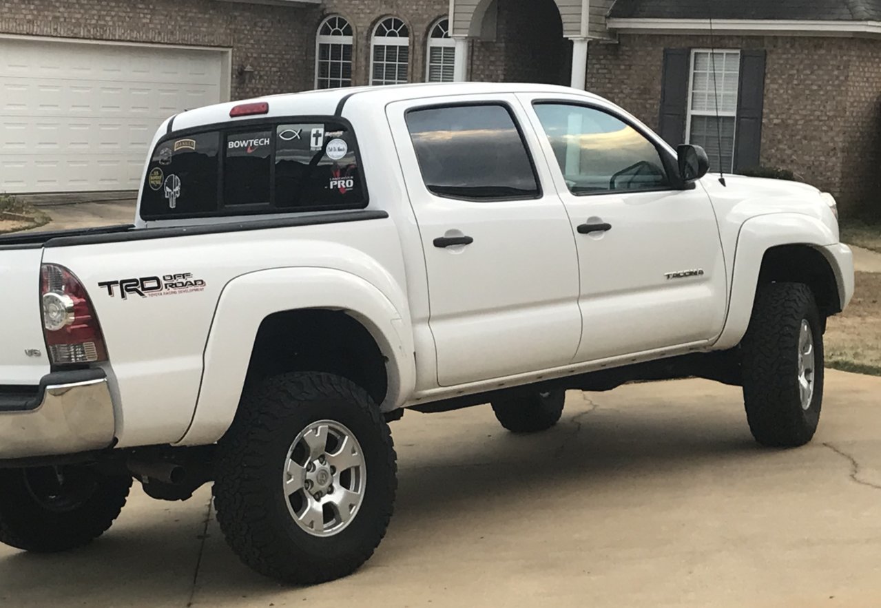

    I ended up with 4 inches on Option 3. Hopefully things settle down a little bit. I don't mind the look, but I am getting quite a bit of shutter between 5-15 MPH. Tried carrier bolt spacers and shims with no improvement. I will try a slightly shorter carrier bolt spacer and see if it helps. IMG_6834.jpg

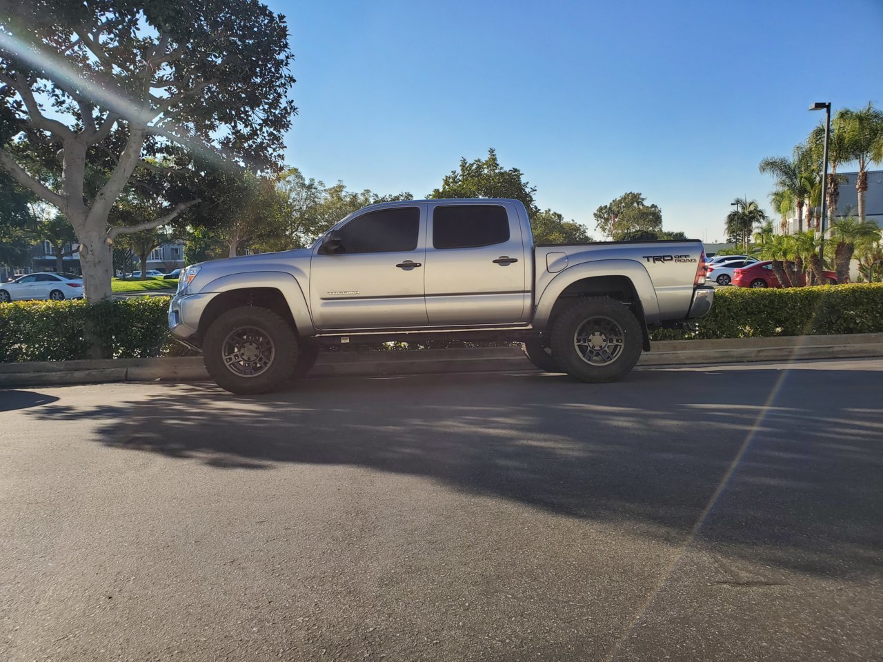

    For anyone trying to decide here is my recent experience. I went with Option 1 because I always have an empty bed. Yesterday I picked up a go kart for a buddy of mine for his son's christmas gift that weighted 399lbs (according to the box). We drove about 60 miles back home with it in my bed and my truck rode amazing. BARELY any drop in the rear at 400lbs of load on the bed. This photo is how she sits with a 2.5" lift in the front with Bilstein 6112s at the highest clip setting and Bilstein 5160s in the rear with my old leaf packs loaded on the bed as I left the shop after installation. Hope this helps someone trying to decide. Option 1 if you rarely load more than 400lbs on the bed or tow heavy. Option 2 if you have a camper or a tent and such heavier items and Option 3 if you have a lot of weight such as rear metal bumper, camper, tent and the whole nine yards.
