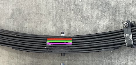

    Hey guys! hope all is well. currently i’m in option 2 but i’m looking to go to option 3, i’m just kinda confused on where that leaf goes? if anyone can show a pic or let me know that’d be great! i know i know it explains it in the directions but i’m still kinda confused

    So since i’m on option 2, i removed that one leaf and added the extra leaf that the pack came with. i’m basically askinh where that extra leaf that i pulled out of the pack goes in order for it to be on option 3. maybe that makes more sense? haha

    The extra leaf goes in between the 2nd & 3rd spring. Check out Icon dynamics website for the pdf installation file.

    Since RXTs ship option 1 and you're option 2, I'll assume that you removed the #3 leaf and replaced it with the extra leaf. To go option 3, you would add the leaf you removed (OG #3) and make it the #4 leaf. Remember, long end goes towards the front...
    Pic for reference...Red: OG #2, Green: Extra leaf, Purple: OG #3

    I'm confused. :annoyed:

    I'm good to go. Thanks again!

    Thank you!! very helpful. exactly what i was looking for !
