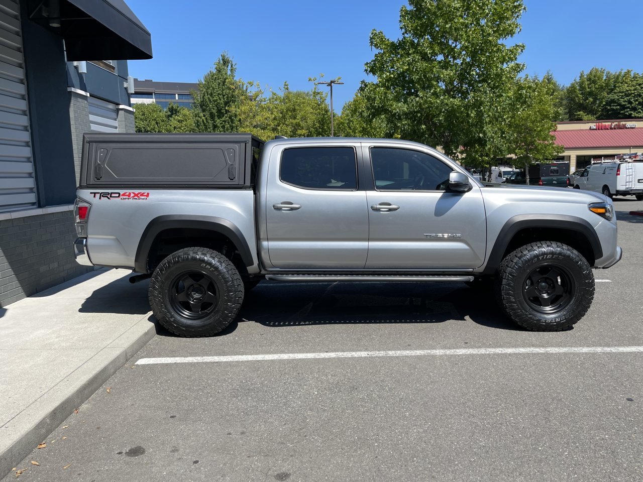

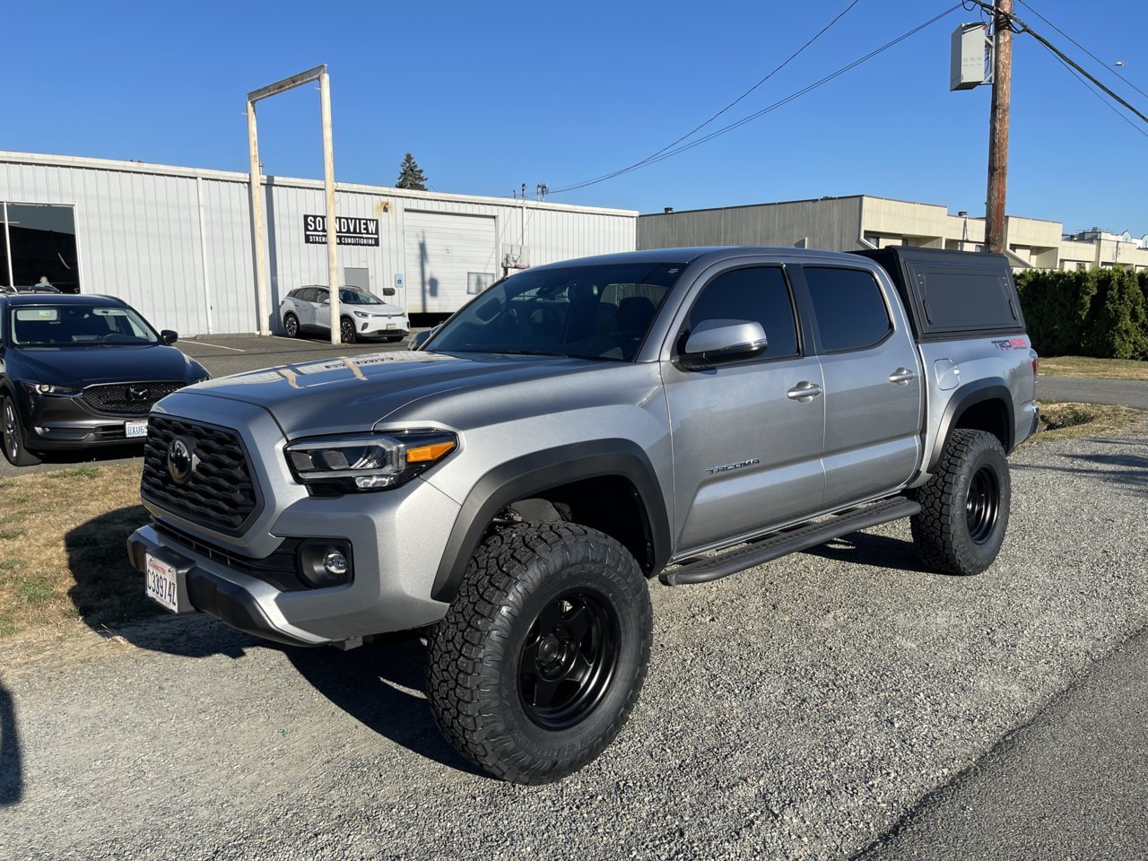

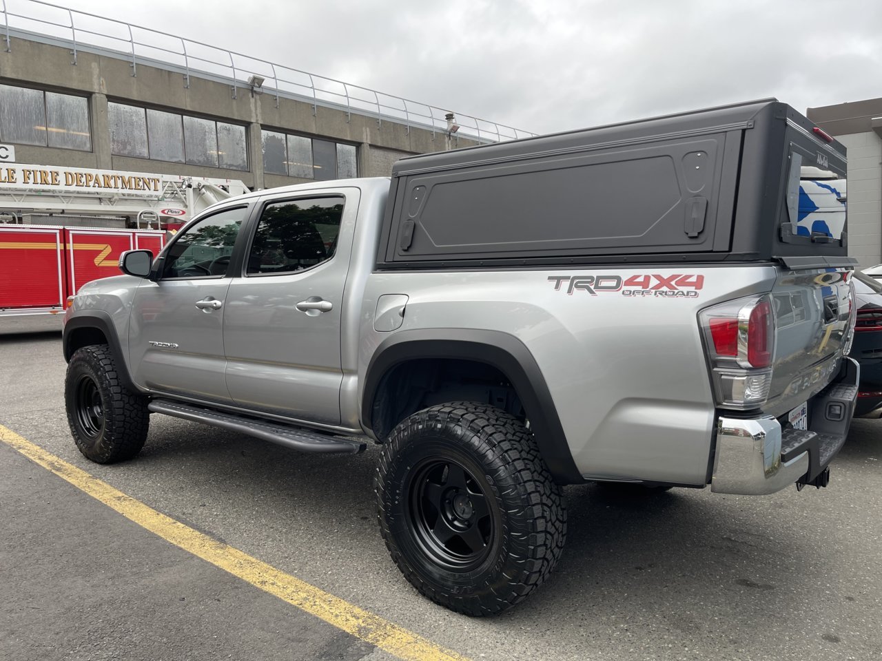

    3.
    It just gives you more headroom to work with regarding weight. I don’t have a ton of weight, am running stage 3, and have no issues with the way it feels.IMG_1989.jpgIMG_1950.jpgIMG_1890.jpg

    Gorgeous truck.
    Really? Rides smooth m?
    Road Bull[QUOTED] likes this.

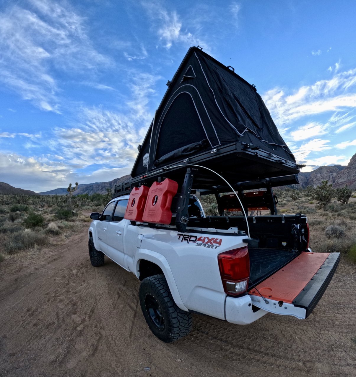

    Definitely option 3. I started with option 2 and it wasn’t enough support so moved up to option 3, just wished I would have done it the first time around.

    also, what’s the orange cover on your tailgate? I like it.

    Hey Mike,
    You have a pretty awesome taco yourself!
    Thanks! I am loving how this thing has come along. Of course ride is a subjective metrics, but I would say I like how it rides. I am running Bilstein the 6120/5160's combo. I found the stock OR suspension was WAY too soft. I hated the nose dive I'd get with braking and how soft the stock leafs ran. My new suspension feels much better supported and appropriate for a truck. My taco is my DD and I don't feel like I am getting jarred around on our bad roads here in the PNW. I've yet to get if offroad much just yet as I just got it installed a few weeks ago, but I am looking forward to a nice shakedown soon, maybe this weekend smoke permitting.
    If you look at Icon's guide, you might be tempted to try Stage 2, but just start thinking about what you have for weight even before adding an 80 lb. cooler, tents, chairs, tools, and whatever else or whoever else that you might be riding with. There's a big jump in weight handling capabilities from Stage 2 to Stage 3. My Stage 3 is fairly new and will only settle down as time goes and weight is added. If just feel that Stage 3 gives you some headroom further down the line.

    Thanks, it’s made by Mountain Hatch, it replaces the ribbed tailgate panel for a flat surface.

    Thanks man. I really love how boxy these canopies are. But the lift and tires turned this from looking like a work truck into something a little more adventurous. I am glad I went with the Stage 3 from the get go. This is the stance I was looking for and it doesn’t feel like a Conestoga wagon. Hahaha. I should still have a bit of stance when it’s loaded up.
