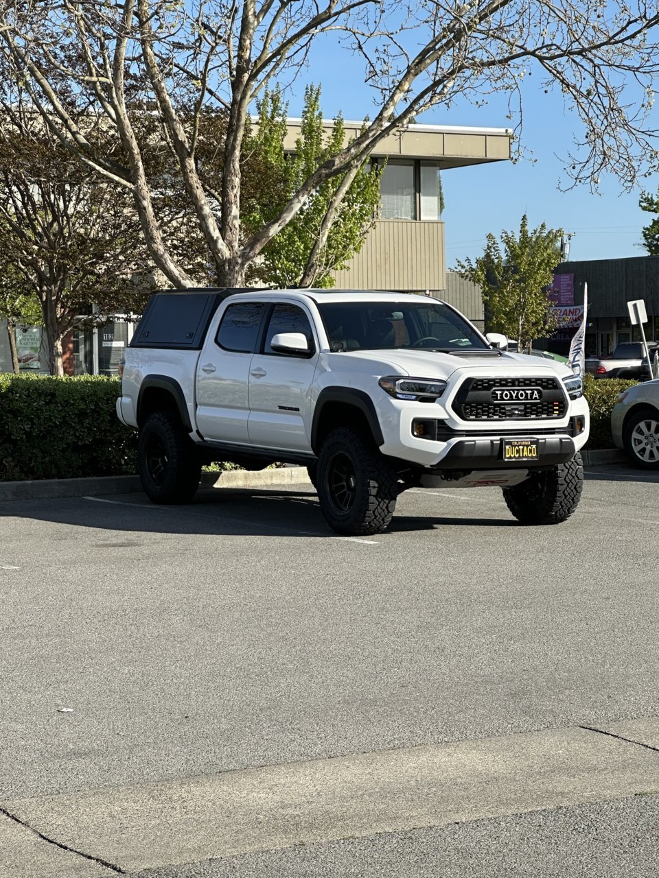

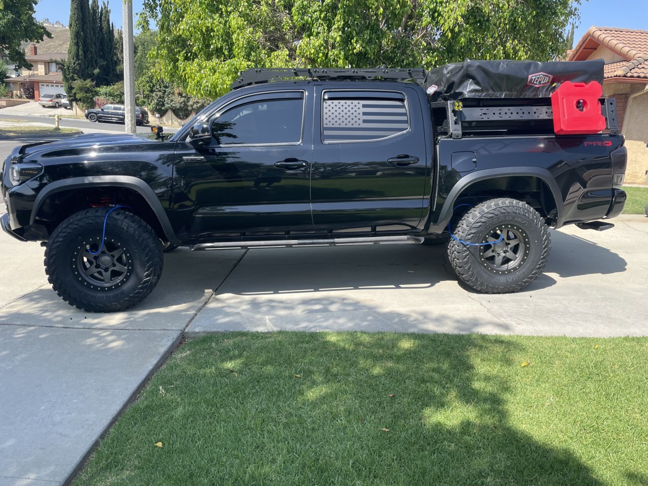

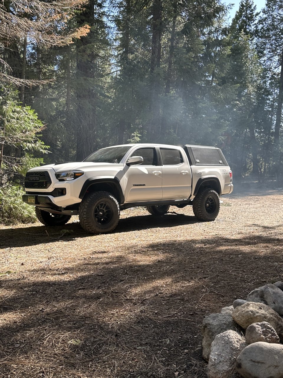

    I am running the Westcott kit up front and RXTs at stage 2 without the Westcott block. RSI Cap + recovery gear and full size spare has me around 230-300lb bed weight depending on what jack I bring. Longer camping trips I’m around ~400lbs no issues. I also run the Archive Garage Bumps and flip kit, highly recommend them. I’ve also got sliders and steel trans/transfer skids so keep that in mind.
    In the first picture I’m around 300-325lbs. Slightly off camber but it gives you an idea.
    The second picture is cap + full size spare (285/70/17 duratrac) 220-230 lbs

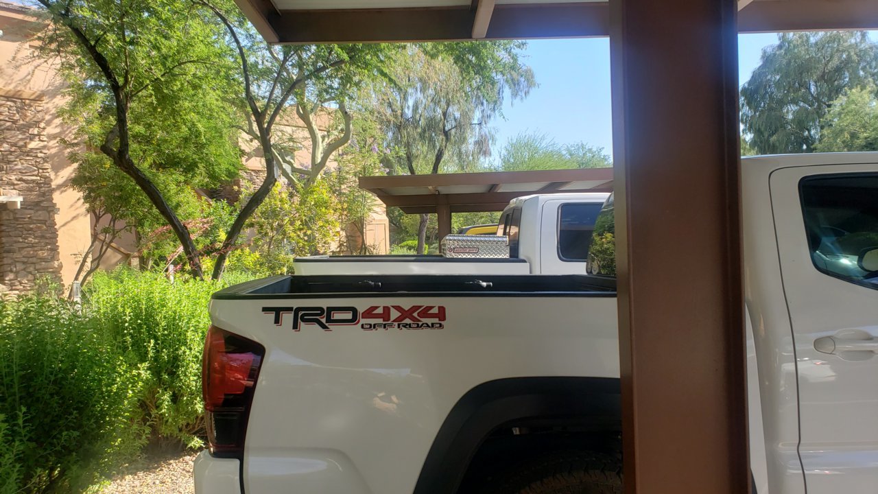

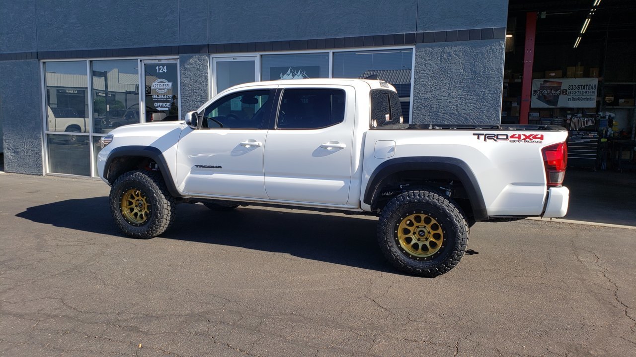

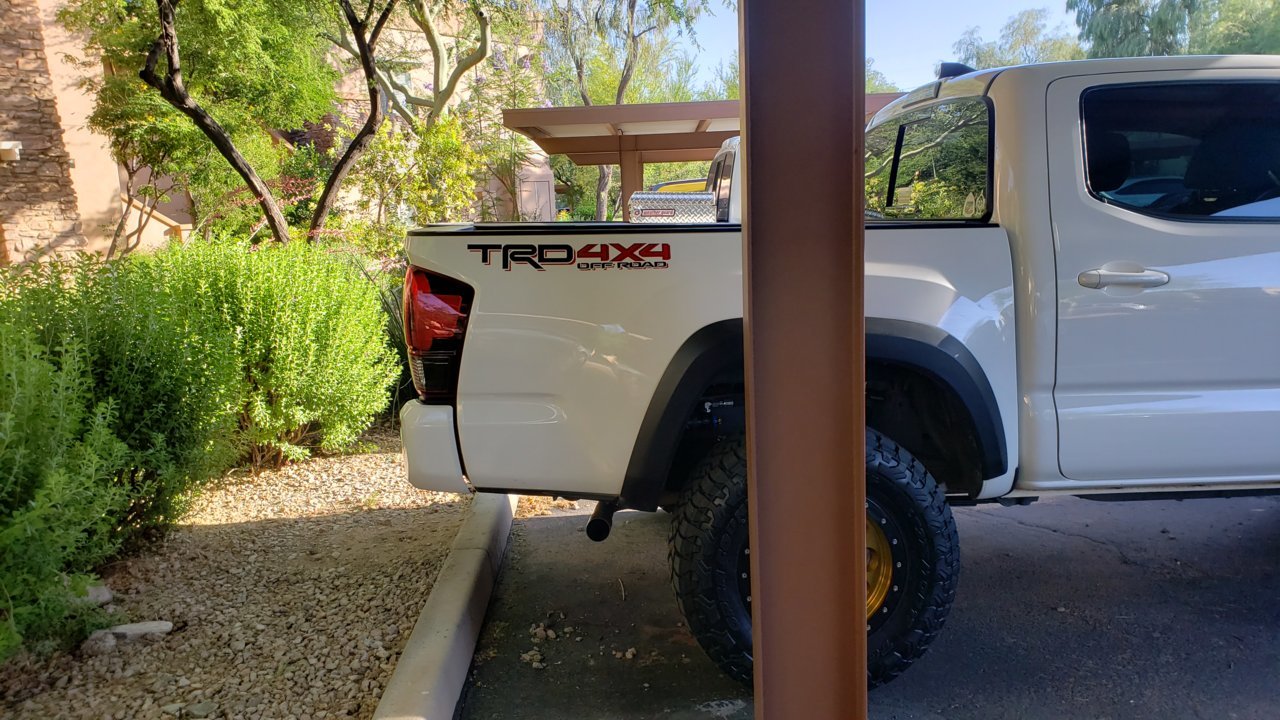

    Currently stage 1 as don't run that much weight maybe 100lbs when I go camping.
    I'll be moving to stage 2 when I get a GFC.
    Talked to a few guys running GFC that went stage 3 and ended up dropping down to stage 2
    Have about 1 inch of rake back is 25 fender to hub front is 24. Both will settle a bit
