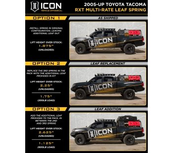

    I’d guess .5” - .75”, depending on your load for option 1.

    Yeah, I see the unloaded measurement, but they don't mention anything about how much it drops with a load specifically for option 1. It looks like about 1/4" per 100 lbs based on the information provided, but I'm curious to see if it's really that linear.
