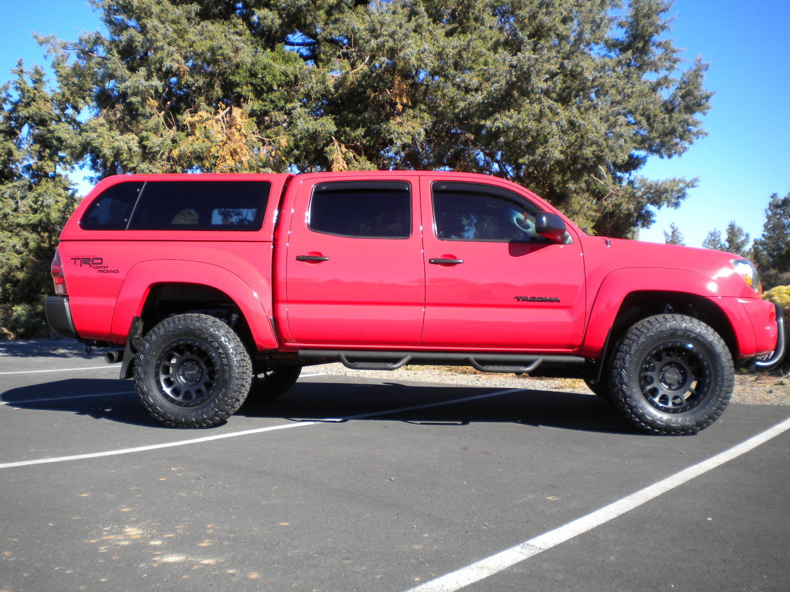

    I went with option 2... been on for a couple years now. Hub to fender when new was around 24.5"... now 24". Have always had the canopy / 200lbs of sand in the winter months. Hoping it settles to 23.75" to get back to factory rake of 1.75" (front lift is 2"... 22" hub to fender.)

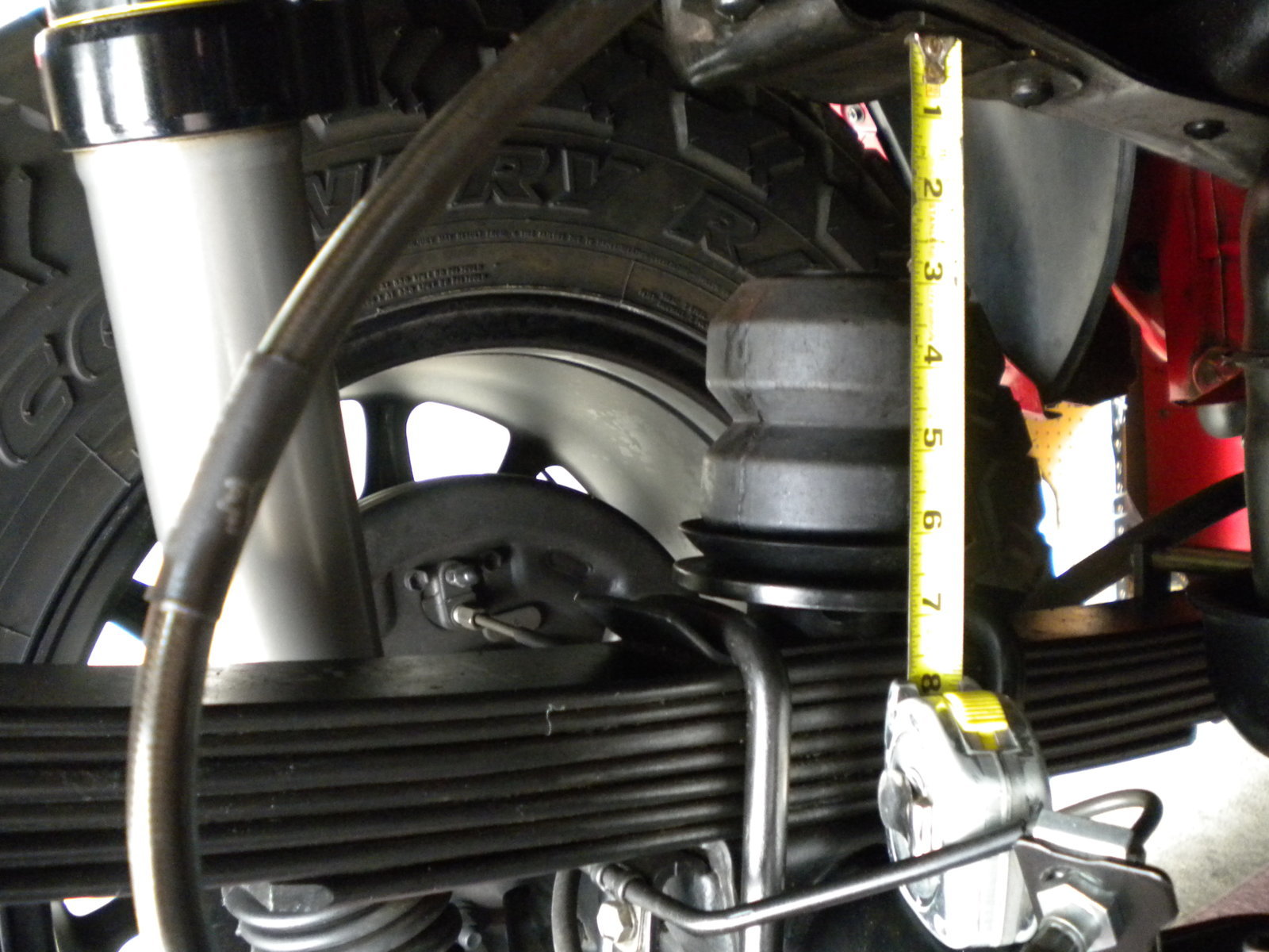

    I’ll take some measurements today with option 3 for reference for anyone interested

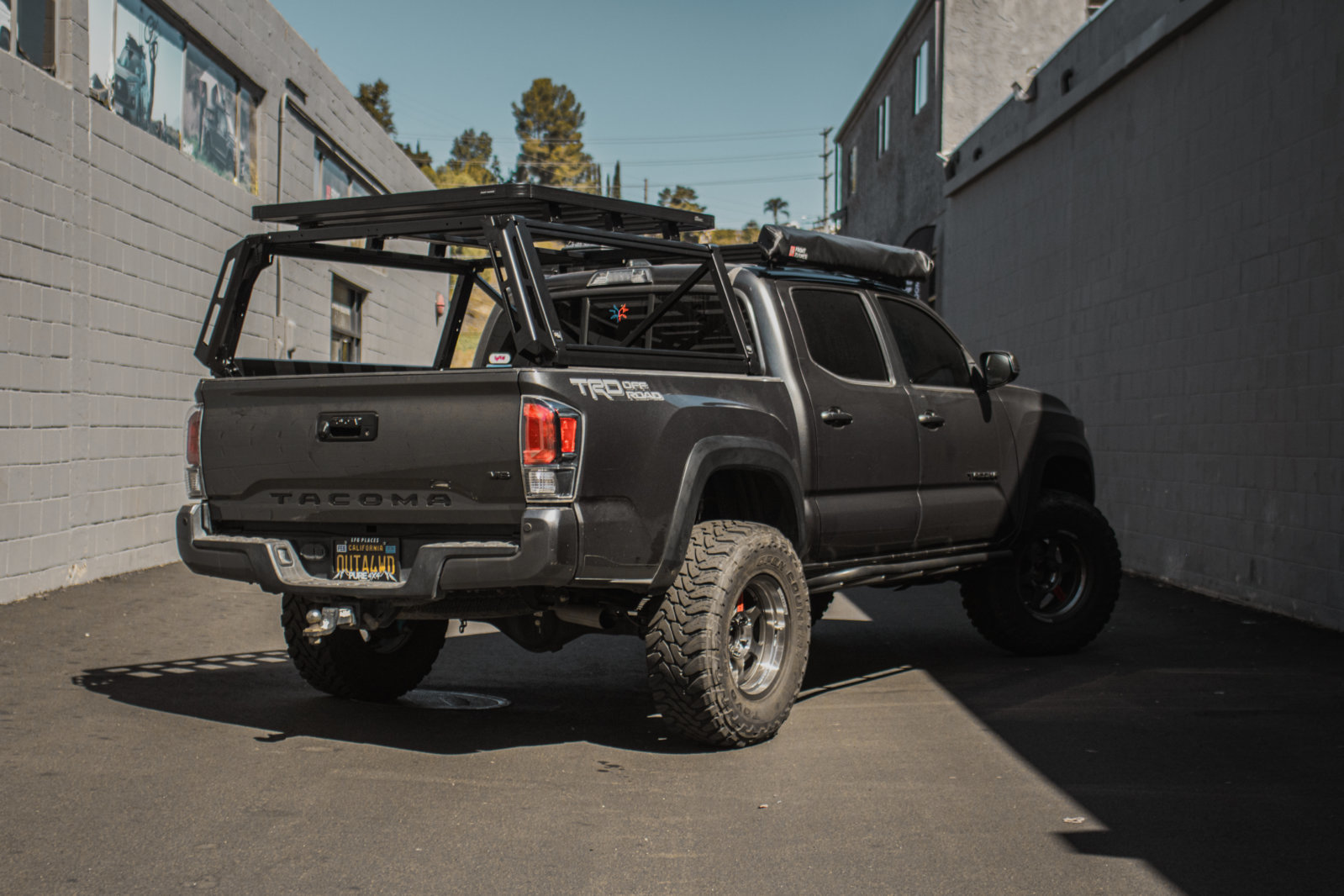

    Hey Guys!
    Just upgraded to Front Runner's new cab height bed rack called the "Pro Bed Rack". The total weight for the configuration pictured is 168lbs and it is currently sitting on stage 1 of the Icon RXT Pack. When I add an RTT and accessories I will upgrade to stage 2 but for the time being, the stage 1 setup is taking like a champ!

    this might help for configuration for you. IMO leave it on option 3 rake is good. Plus if you decide to add more weight. You’ll be changing it again Imo
