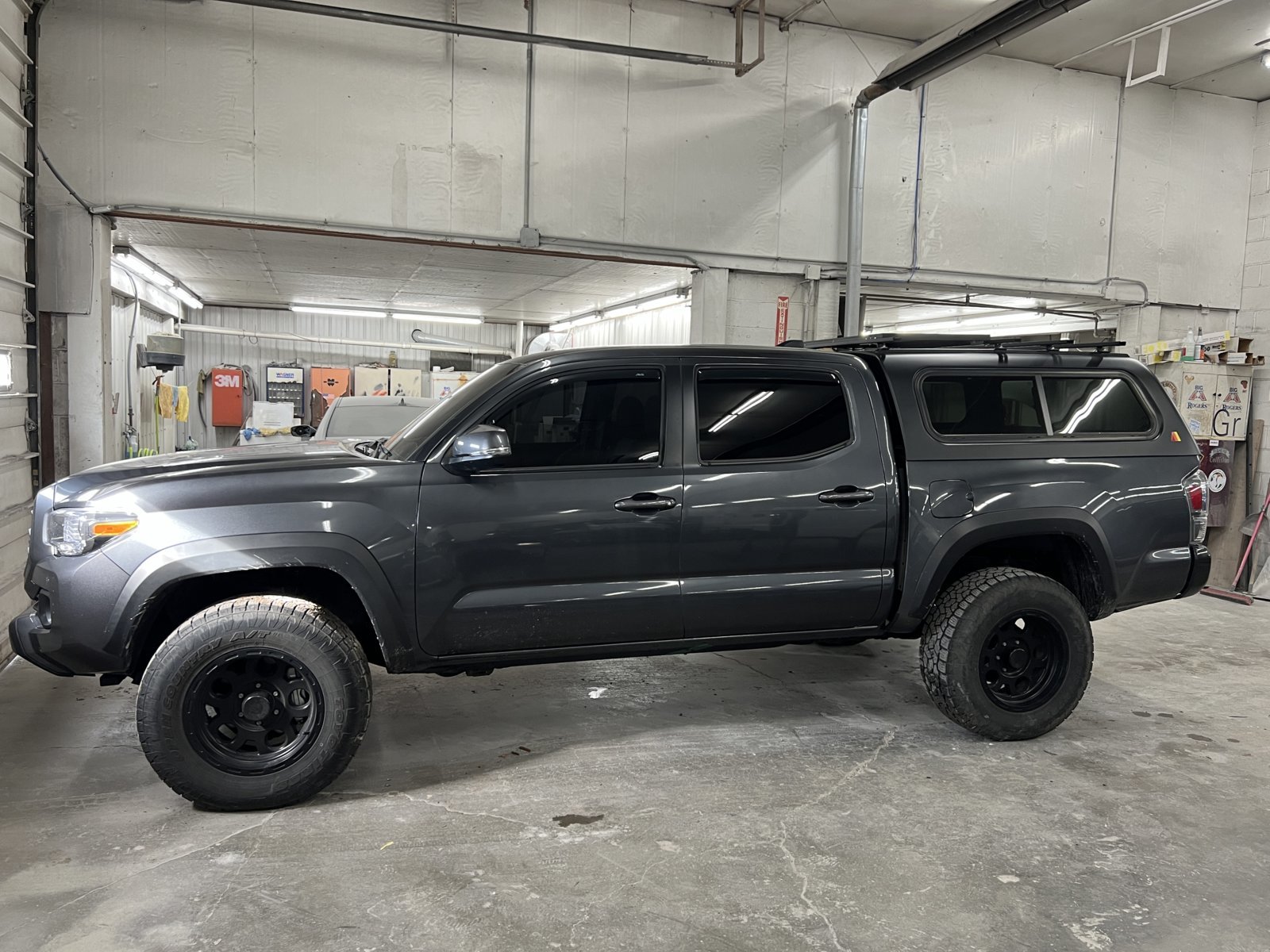

    Ended up going option 1 mostly out of laziness, but I’m glad I did. Sitting at 23 1/4” hub to wheel well with roughly 350-400lbs on the back. Rides significantly better even with having stock shocks still.
    This is before, without my bed drawers which are probably another 150lbs at least.

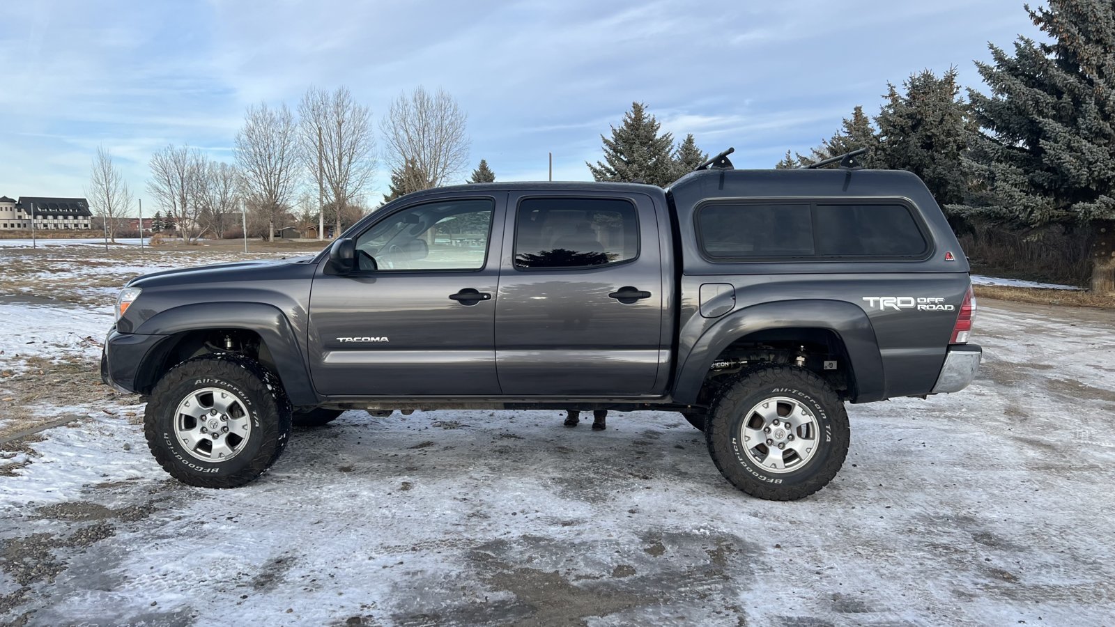

    Got the RXT stage one upgrade system installed friday paired with Icon 2.5 VS IR coil over front shocks. The goal was to gain a lift, better ride quality over stock components with 140k and be able to haul/tow without dragging. I had them install option 2 leaf pack and I believe the front coils are set to Icon factory recommended lift. So far I’m happy with the ride but the rear end seems a bit high. What do you guys think? I like a bit of rake but a little less what would be the recommended strategy. TIAIMG_6497_Original.jpg

    should settle with a bit of time but it looks great to me!!

    Looks great!! Rake is perfect :thumbsup:

    Cool! Just very different from old saggy stock

    Definitely. Not a fan of a saggy rear :)

    Looks perfect to me. Like the rake angle.

    Awesome, I think it's perfect! It looks like a workin' man's truck,, not a Karenlina Sqauttin' "rig"

    something i found out is that the 2.5 icon shocks have 150lbs of applied force each due to the high nitrogen charge and 7/8" shaft. thats 300lbs extra pushing the rear of truck up over a non charged shock. my truck on option 1 sits level with rear shocks disconnected. with shocks installed rear is 1.5" higher.

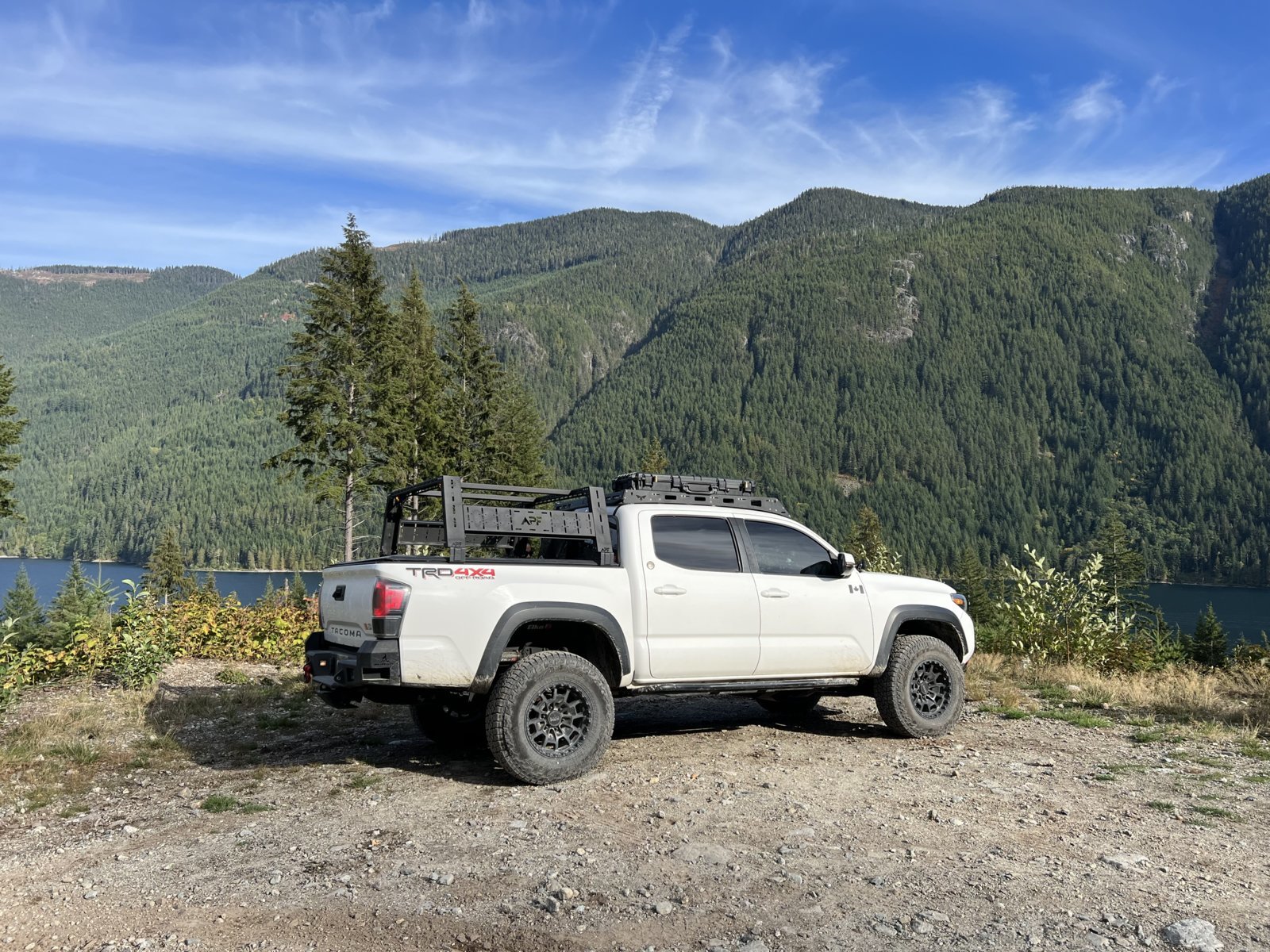

    I was in the same boat as you. Option 3, over 25” from fender to center of hub, and how to secure the e-brake cable.
    I have had my leafs installed for over 6 months now. They are well broken in and it feels great. The rear end has settled down to 24”. My bed is empty 90% of the time but I always have a steel rear bumper, full size 33” tire with matching rim, bed rack, sliders and full skid plate. I reused the factory brake cable mounts but drilled out the holes to work on the rxt bolts.

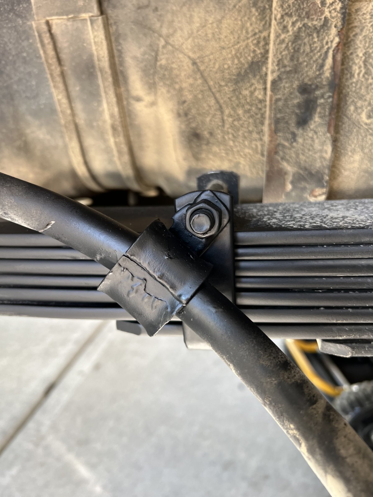

    Don’t bother with a spacer. I bolted my brake mount on upside down on my Icon and haven’t had an issue with rubbing or tension. I can flex the rear without issues
