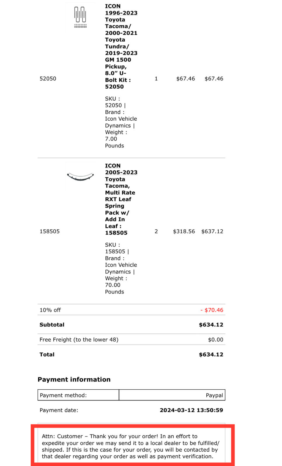

    Pulled the trigger on the RXT pack directly from Icon. The $634.12 out the door held up.
    We’ll see how the free freight plays out. Once my order confirmation email came through I noticed this message at the bottom. Not gonna be super pleased if I end up having to burn too much time/fuel going to a dealer to pick up.

    I just saw that they dropped to $300.78 per pack on Amazon. Shipped and sold by Icon. $634 out the door with the u bolts still a better deal than buying on Amazon and having to get the u bolt kit.
    @backcountryj were you charged any kind of sales tax? Or are you in a state that doesn’t charge online sales tax?

    No sales taxes where charged. I’m in GA, which normally would have applicable taxes if the retailer has a store front within the state. I’m not sure if Icon is an exception, or if they’ll attempt to charge taxes upon pickup at a dealer.
