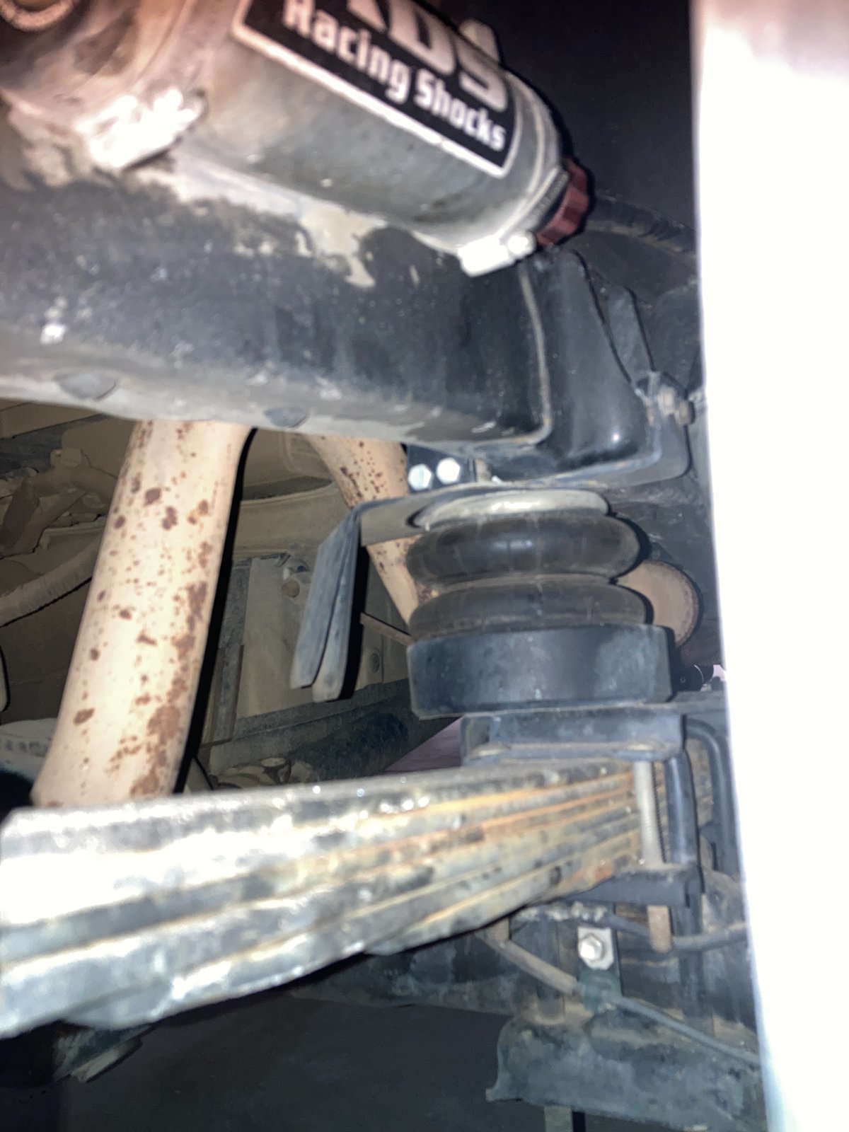

    Step 1: get rid of blocks
    Step 2: install new leaf pack
    I’m running 23.5” front and 24.5” rear with stage 1 and bags. Super plush ride in any scenario
    If you ever want to have a very versatile option just get airbags and cradles in any scenario (5psi-35psi) that still articulates as much as you will need
    I run light (80lbs in bed) mat and box with supplies. The cradles and airbags make it so versatile. Offroading to towing my 4000lb trailer is simple

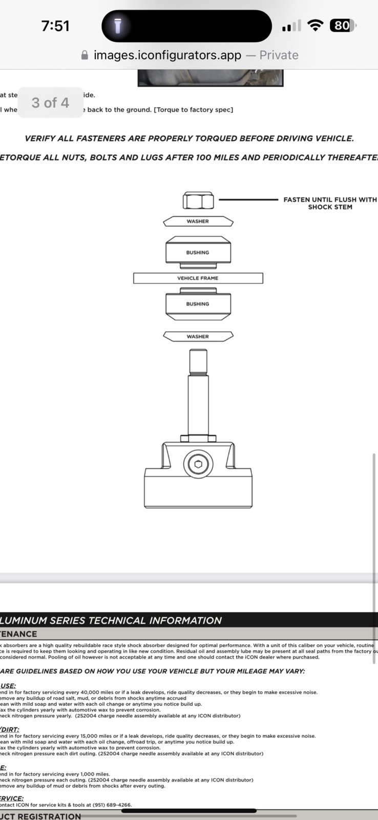

    Any of you guys seen anything like this before? I installed icon RXT option 2 along with the 2.0 aluminum shocks in the back and my passenger side sock is moving around in the bucket. The top nut is torqued to spec and as tight as it will go bc there Are no threads left to tighten it anymore.
    Do I have a bad shock? No leaking or anything

    Looks like your shock isn't tightened enough on the top nut. I'm seeing the bushing move w.o compressing. I always tighten until it starts to compress, then stop.
    You can add a couple washers to get it to tighten more, seems weird. Did you forget the second bushing pad thing? There should be two on the top, one on either side of the frame mount.

    It’s as tight as it will go. I’m out of threads and while the washer idea might work I feel like something is wrong. I shouldn’t have to add washers.
    bushings are correct according to the instructions so I either have a bad shock or I’m missing something. The drivers side is perfect.

    Yeah that looks like the lower bushing is either missing or things aren't tight. Rear shocks snug up tight tight.

    Take it apart and give it a look. Something is missing

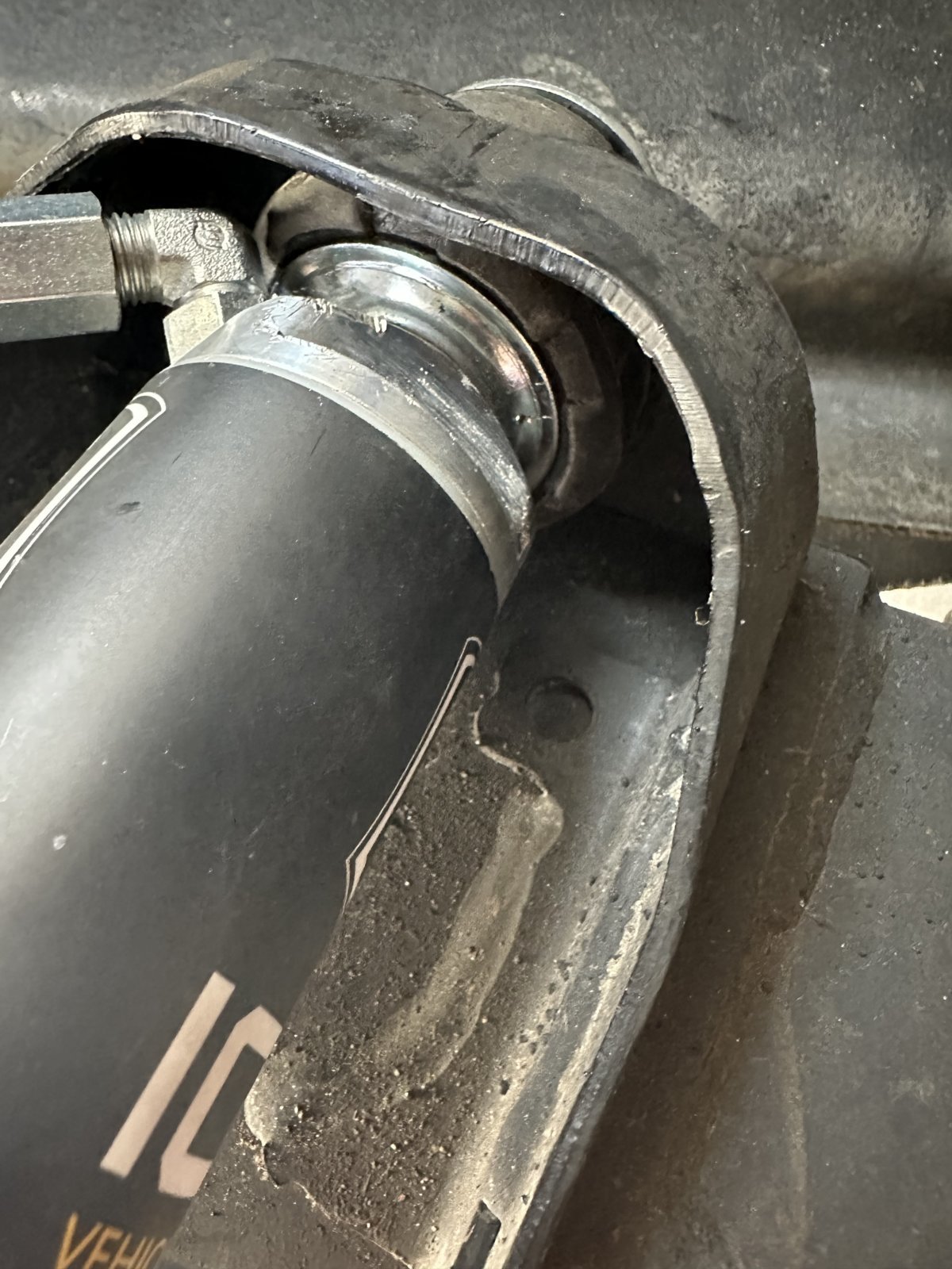

    It’s as tight as it will go I don’t have any threads left to tighten it down more. It’s not cross threaded or anything either. Here is what it looks like underneath. Bushing and washer are in correct location. I marred it up a bit because I was holding the shock in place so it wouldn’t twist to get it as tight as I could.
