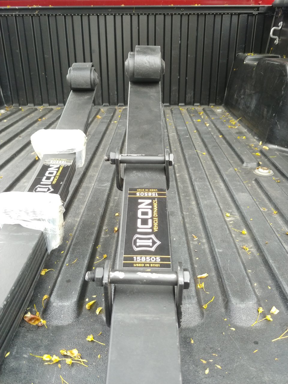

    UPS dropped the leafs off today while I was at work. The optional 8th leafs get delivered tomorrow.
    The front mil wrap on one of the packs seems way off. Think that's something to be worried about, or do you think I can tweak it back towards the center when I undo the center pin and step up to option 2?

    I think it looks ok!

    Yeah that can be aligned once you loosen the center pin.
    You’re adding an AAL to the RXT pack?

    Its fine, you can move it back to center

    Yeah you guys are right, once the pin is loose they all rotate individually. Will be a bit of a challenge for my ocd ass to get everything lined up, but no big deal haha
    I should have worded that better.. the extra (8th) leaf that you swap in to make either options 2 or 3 gets delivered tomorrow. Whole setup came as 4 separate shipments, only that one needed a signature though :notsure:
