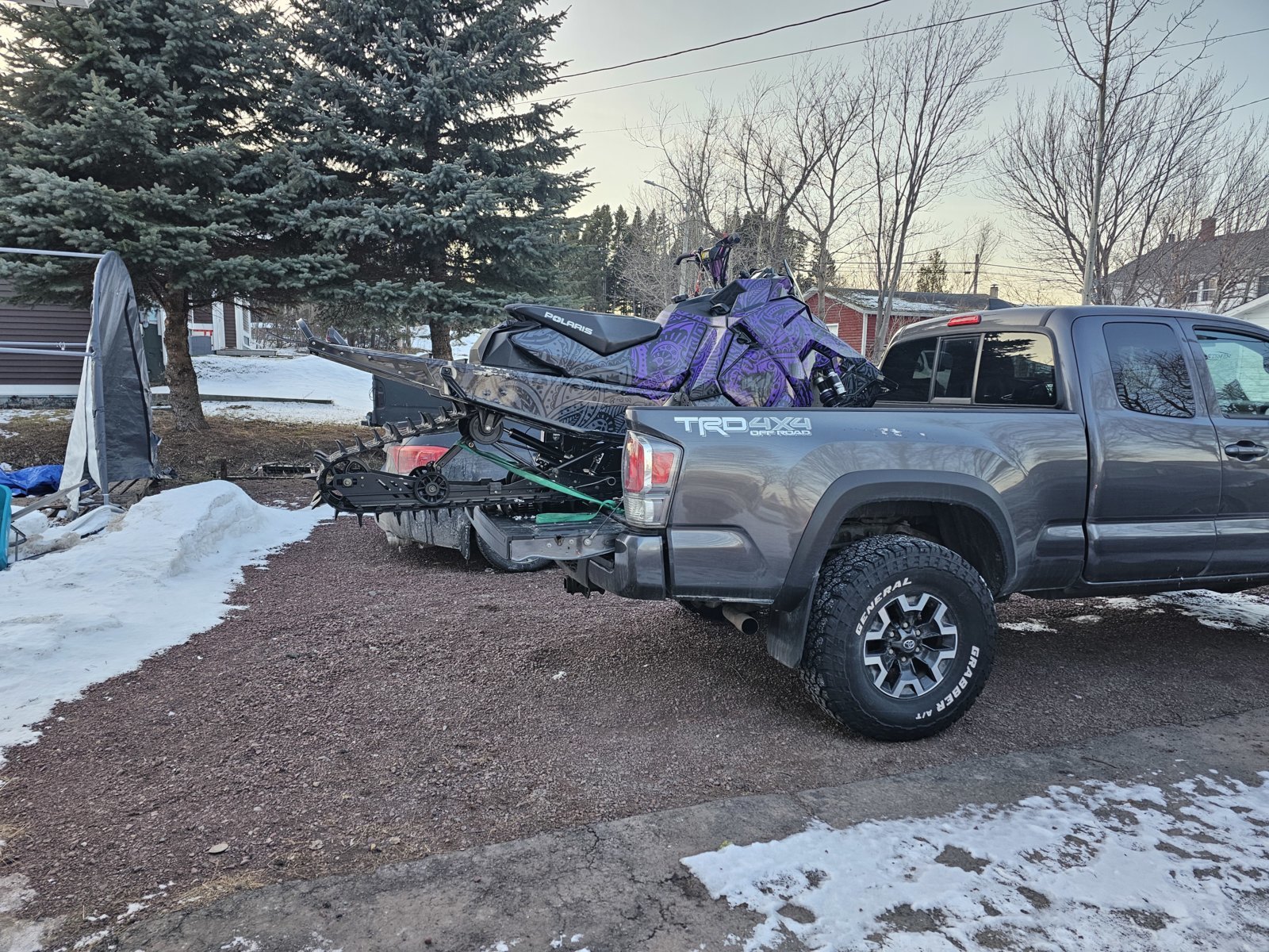

    1000lbs with option 1. it handled this decently. not good. just decent ahaha. had the compression on the shocks turned all the way up.

    Dude…Toyota Tacoma axles aren’t made for this type of constant weight abuse…just fyi. 1000lbs is ok, once in a while, but I highly suggest you get some airbags and cradles for this…best of everything when installed. If you don’t and do this from time to time…your leafs will flatten out and lose a lot of the cushy progressive spring they have = new leafs sooner
    I think I’ve hit 1,000lbs maybe 2-3 times since I have had the truck and every time it’s for quick trips…just sharing from experience.

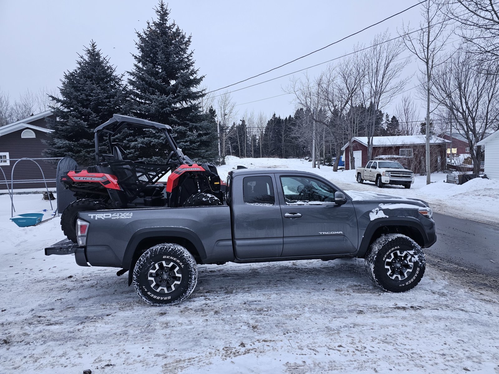

    itl be fine. hell ive had 2000lbs of stone in my 95 many times over the years. truck spend 95% of time unloaded and i dont wana sacrifice any travel or ride quality. if they ever sag il swap the option 2 leaf in. i am swapping to durobump stock length bump stops and hammer hangers tho.

    Wow. Does the rear shake or shimmy at all?

    Seems dangerous to place that much weight behind the rear wheel.

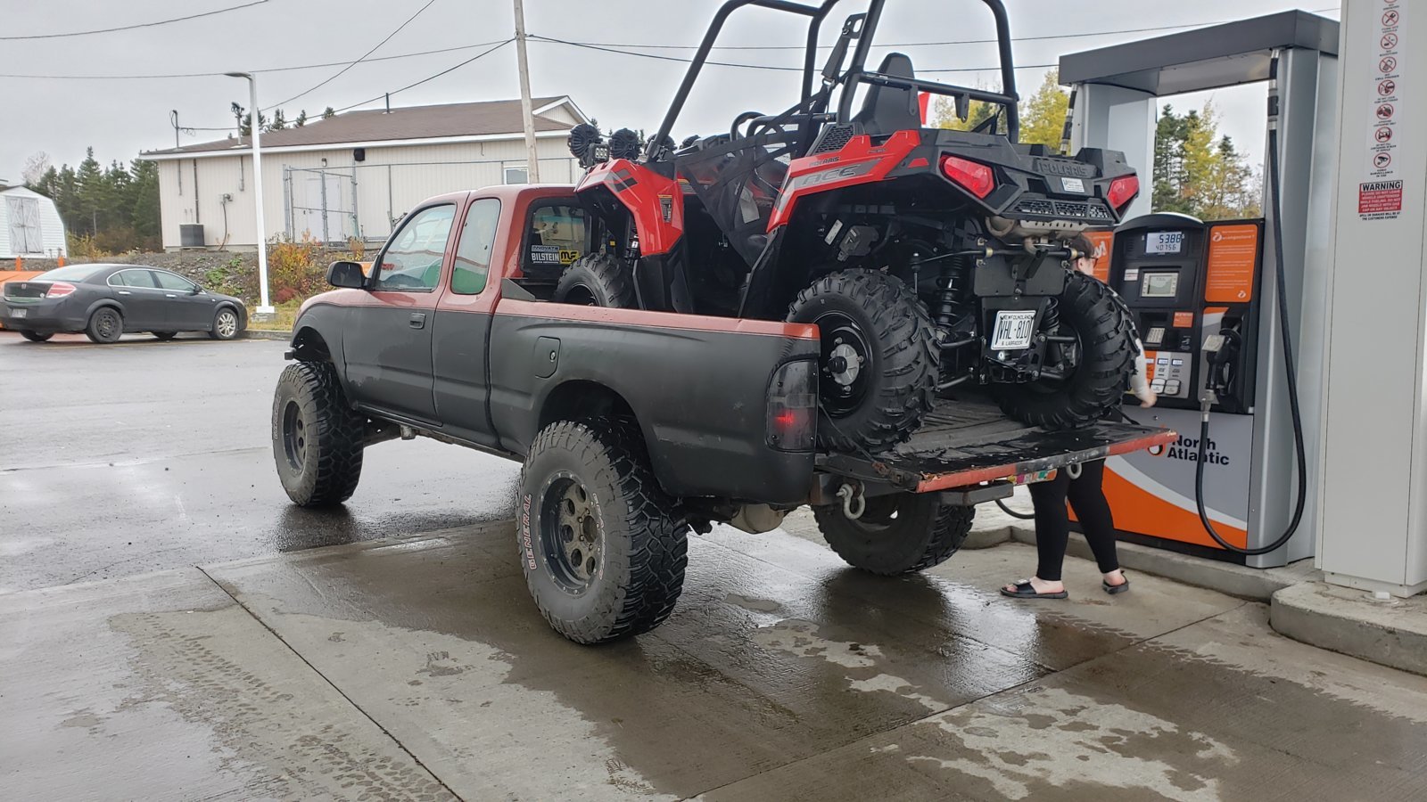

    the 1st gen still drives better than the 3rd gen ever did. it does almost everything better tbh. i think your underestimating just how much weight some these overland guys put on on their trucks full time and still offroad like it. full armor, skids, sliders, winch, large spare tire alone can be 500lbs. thats before the actual overland setup and all the unnecessary things they bring. im just using my truck which has no extra weight and starts off being a lighter access cab to begin with to bring a load from point a to b. i drove 4 hours on the highway with 1000lbs in bed and it drove wonderful. majority of the time i didn't know there was any extra weight at all. i am running the icon bypass shocks which handle body roll much better than my kings and with this much weight the piston is entertaining the built in bump zone where valving is much stiffer. i do think that is a big factor with how the truck drives.
