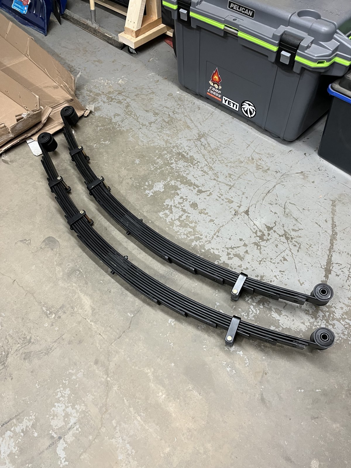

    received my packs around lunch time.
    IMG_5515.jpgStage 3 ready to go in this weekend!

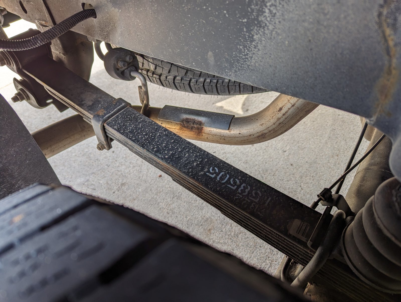

    Did my install today. Had the icon add-a-leaf with the overloads still in. IMG_5523.jpg Went to the rxt option 3 and gained 1.25-1.5” in lift with my RSI smartcap. It was level with the add-a-leaf set up, but now I have some rake for the extra weight. It rides so much better.

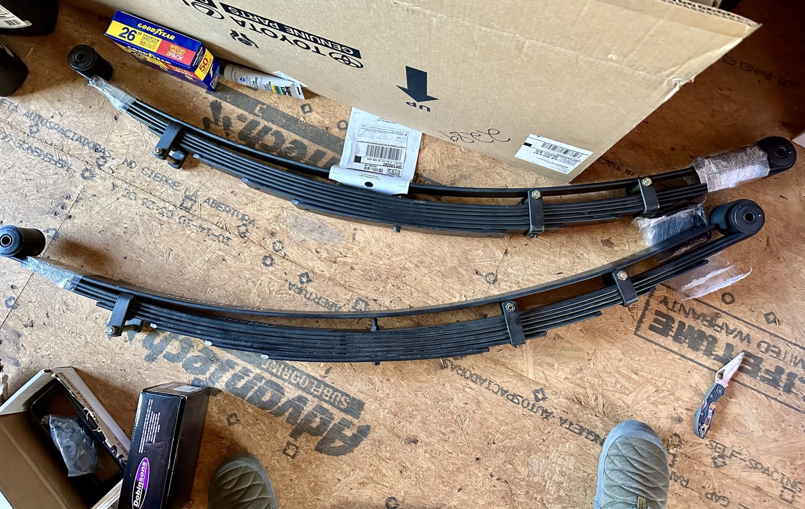

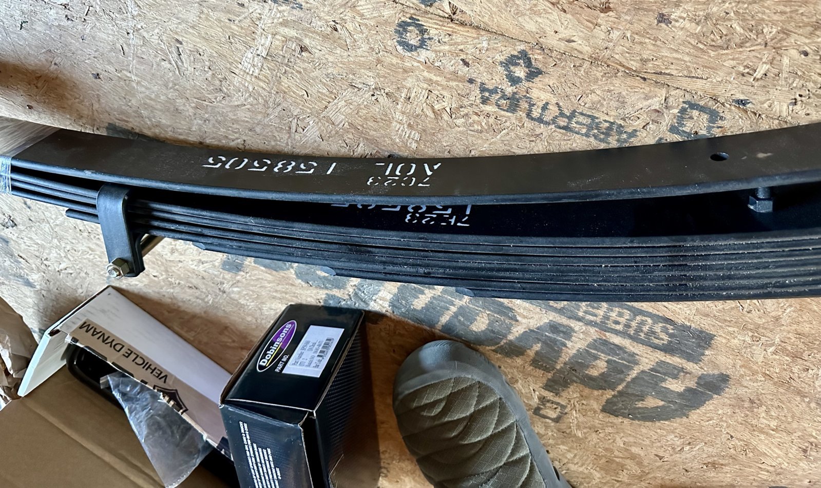

    Possibly a dumb question, but one I’ll ask anyway.
    Which end of the leaf pack is the front/fixed end and which is the rear/shackled end? And are the packs side specific, drivers vs passenger?
    Also does the writing on the extra leaf go on the same side as the writing on the built pack? Essentially install in the same orientation as it comes shipped?

    Writing/single clamp goes backwards. Match the writing orientation when installing the extra leaf, ircc it will only fit one way because it is longer on one end.
    Either leaf can be driver or passenger

    A little tip to add to that, check to see if one leaf or pack is arched more than the other, then put the higher arch on the drivers side for extra weight. Same springs, doesn’t mean they’re the same. If ya know what I mean.

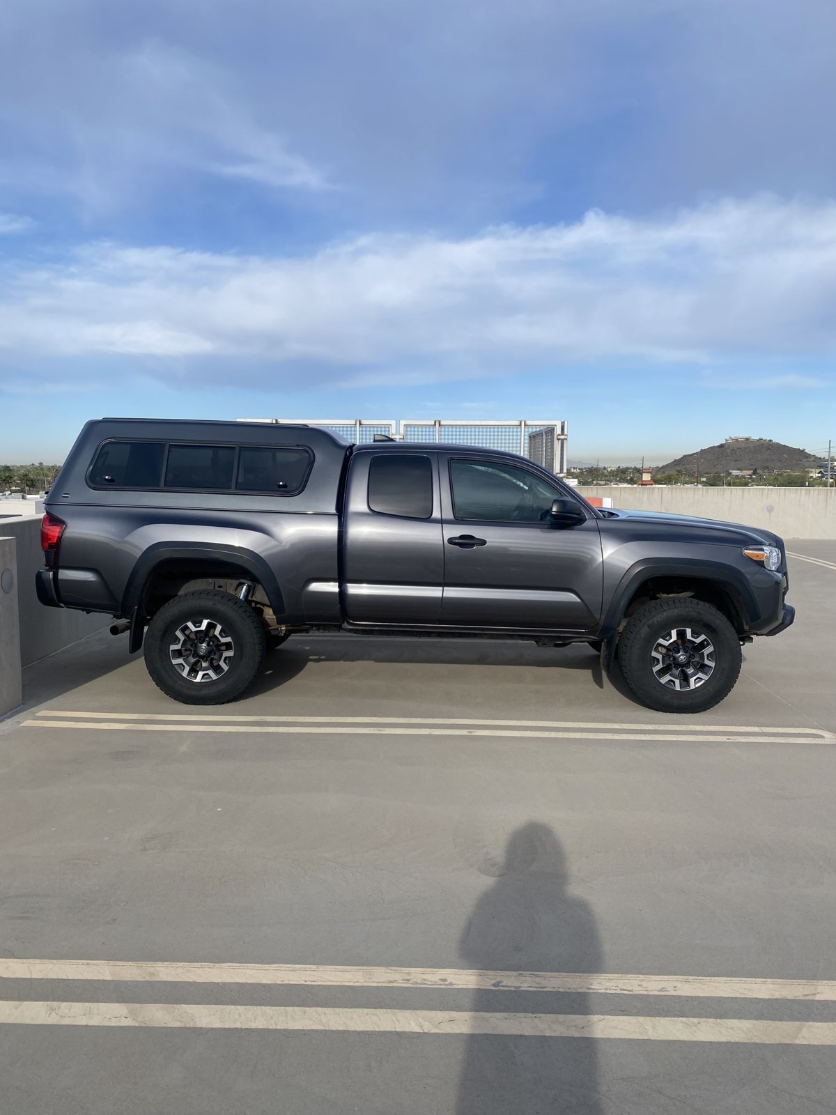

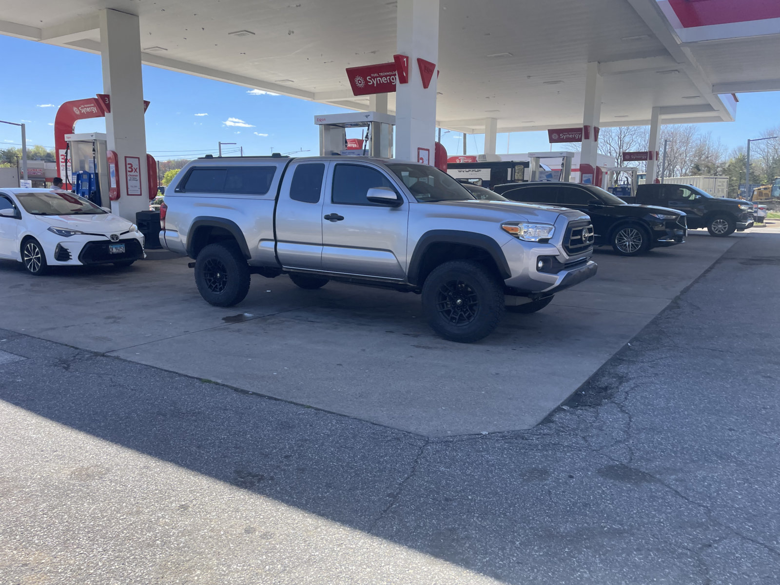

    Icon RXT Leaf Pack Option #2 installed on a Tacoma SR with V6 and 4x4.
    Stock rear height: 22 inches
    Leaf pack installed: 24 on driver side 24.5 on passenger side.
    Front is lifted 1.1 inch from Bilstein 5100 with stock coils.
    This picture is of the passenger side. I expect it to settle and this is with no weight in the bed except for the shell. Also I don’t think this ground is completely flat, I think it points down a little bit.
    With the little driving I have done so far I will say the back end eats bumps and dips better than before. Also installed in the rear are the bilstein 5125.
    A little high for my current liking but I’ll give it time and throw some weight at it.
    Install was a little difficult not going to lie :rofl:

    Looks great slightly high in the back same as mine. I have your exact setup Access cab 1.1 lift stock coils in front with stage 2 with 5125's and a topper only difference is 2.7 vs 3.5 but i suspect with the iron block they are pretty similar in weight. Mine did settle a little but its very surprising how it holds weight i would have expected it to drop more than it did. I had 4-500lbs in it this past weekend pic below not including the topper and it only dropped 1/2-3/4'' i really wonder what stage 1 would look like on this setup. I may swap the 3rd leaf back to stage 1 to see what it looks like, because either the less weight of the accesscab over a double cab maybe 100-150lbs or icon downplayed their weight capacity/lift.
