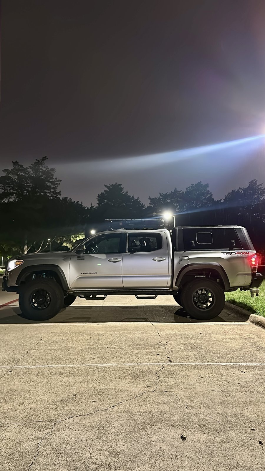

    ~23F/24R, 1” of rake is cool but if I lower the front another 1” I’d be at 2” of rake which I don’t really want

    Can we get a side shot of the truck?

    IMO leave it alone. :cheers:

    Never mind I found photos. I understand that probably isn’t the look you’re going for in Hawaii. But it looks fine. If you add weight it’ll level off also

    Yes looks perfect to me. Jealous he has the shock relocate looks nice.

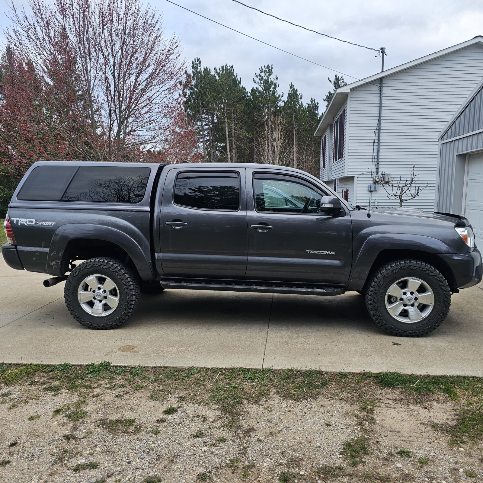

    Anyone ever get 4" (loaded) from stage 2 Icon leaf pack?
    I was at 20-1/2 and 21-1/2 now I'm at
    24-1/2 and 25-1/2...just my luck.
    As of today, stock 4600s all the way around, 6112/5160 will be ordered soon, just wanted to see what the new leafs did first.

    Stock height is around 22" and that is what Icon gives their measurements off of.
    After a few days the pack should settle down at least 1/2"
    Also did you install the stage 2 leaf in the correct orientation?

    I was wondering what stock height should be, thanks for that.
    Yeah everything is installed correct.
    I figured my springs were sacked a little but even at 22"I'm well over the advertised
    1-3/4" loaded number, at least on the one side.
    I don't want to go over 2" in the front, hopefully my rake isn't too weird.
    Maybe I'll grab my boat and tow it around for a week, hopefully it settles in.

    I really think it takes a long time to settle in if youre not hauling heavy weight all the time. I have a AC stage 2 been on about 15k with a topper and 2-300 extra lbs in the bed and it has not dropped much. The other day i threw 4-500 lbs of crap from my garage and thew a big bar into the hitch receiver and gave it a few jumps i am no featherweight at 220lbs to see if it may settle more and nope. I am about 2'' higher in the back now with my normal everyday gear which is 4-500lbs including my topper with a 1.1 lift up front. With the extra 4-500lbs it only dropped 1'' leaving me with a 1'' rake with 700lbs in the bed including the topper. I think they under rate their numbers, stage 1 might not be enough and stage 2 seems to be an inch high for me. I guess i could always go stage 1 and if needed a 1/2'' block/shim if its too low.

    My understanding was stage one wouldn't be great for towing /hauling some weight ,
    that's why I went 2.
    Then I get too much from 2, not into doing things twice. I've put on more lifts on trucks than I can remember. My first Toyota, they seem to be fussy.
    But I read that going in.

    Did you torque the shackle bolts while in the air or when loaded on the ground? If.you did it in the air, then loosen them and see if it drops.

    Floor jack under pumpkin with full load of truck on springs.
