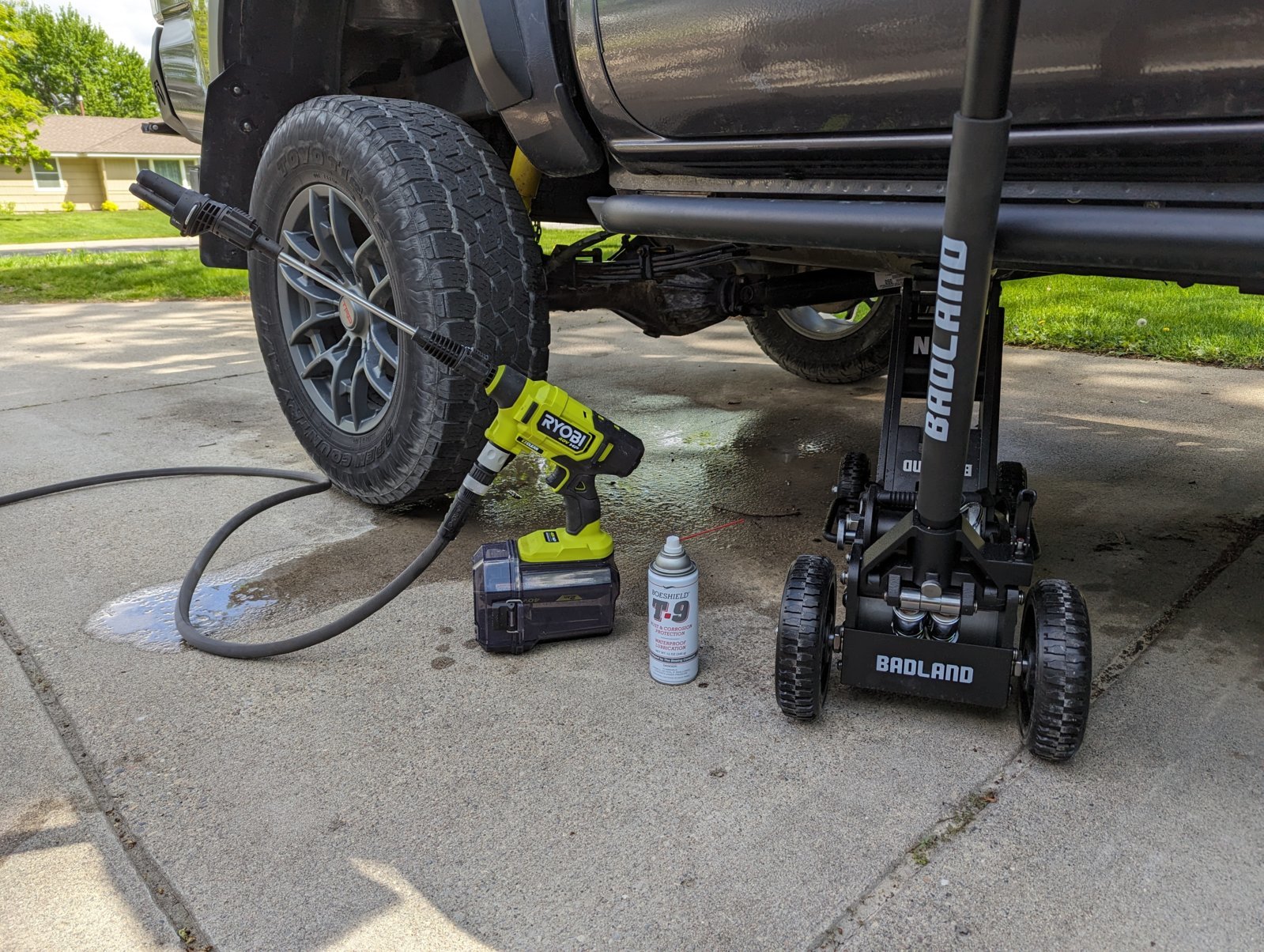

    Did my bi-annual Icon RXT clean out and lube, hopefully no more squeaks for 6 months. Also finally got to use my new badlands jack.

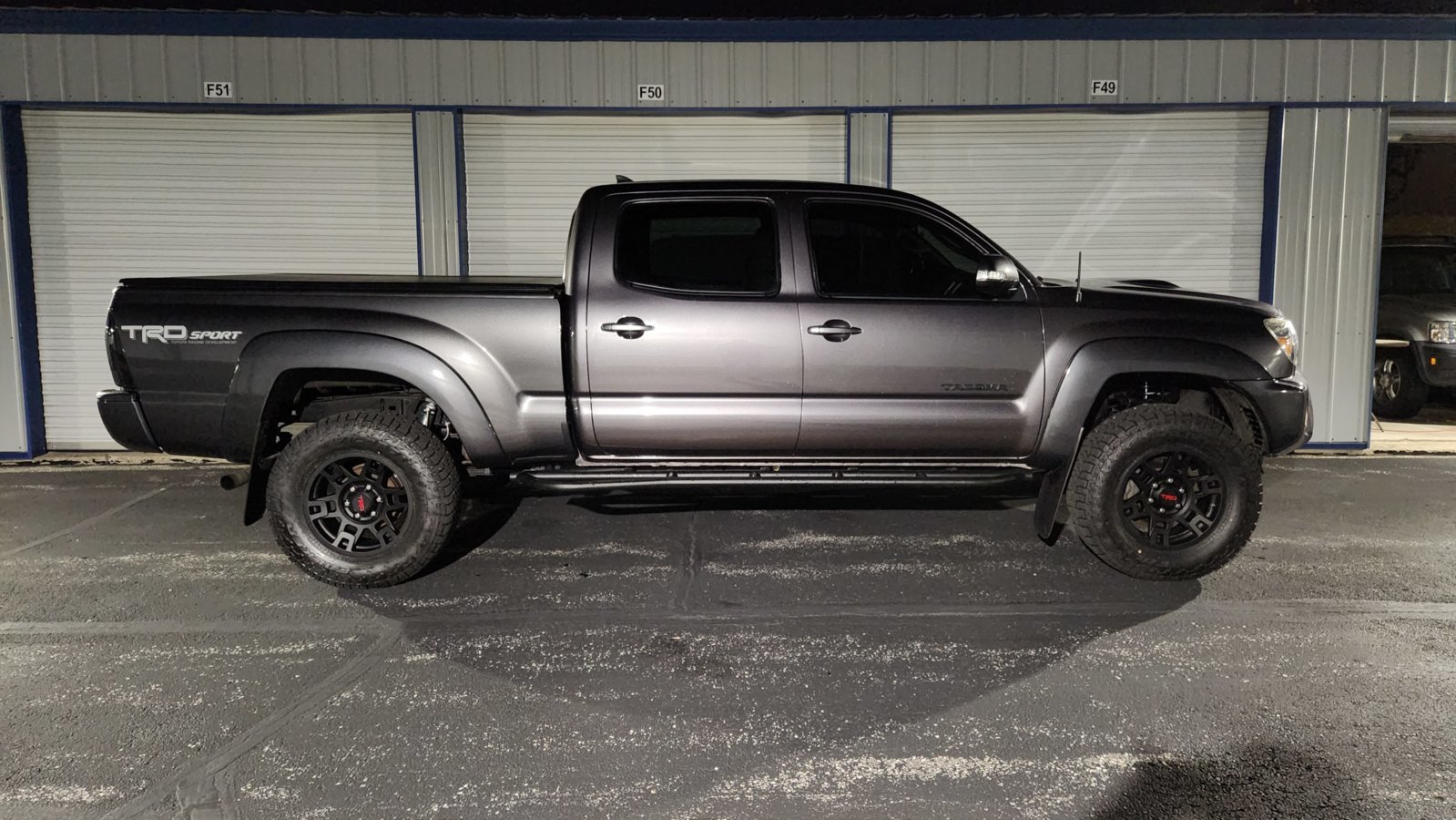

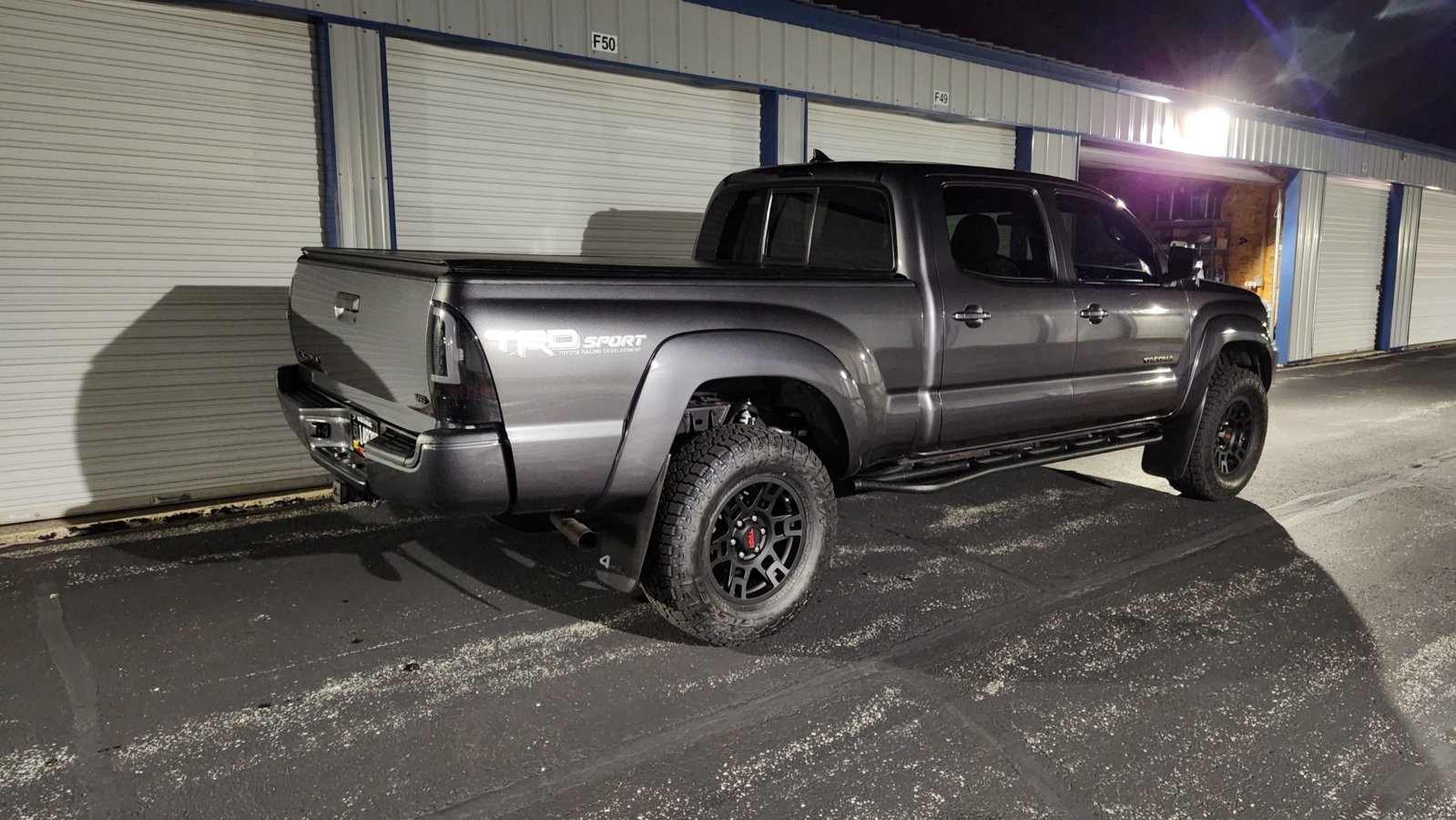

    I couldnt decide between option 1 and 2 since I normally drive around empty, but tow a boat and full bed of gear a weekend per month. I ended up pulling the leaf pack apart and greased between each leaf and put back at option 1 since I thought id get more lift than icon advertised. With only sliders and bed mat I ended up with 1.75" of lift, although they ride much better than stock. Knowing this I probably would have went stright to option 2.
