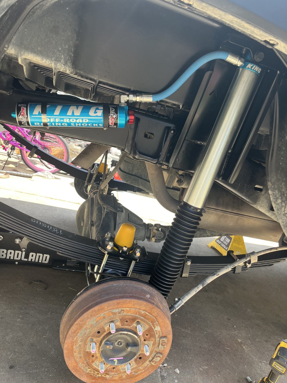

    RXT option#3
    Pista1, AStinkyBumb, chasecmc and 2 others like this.
