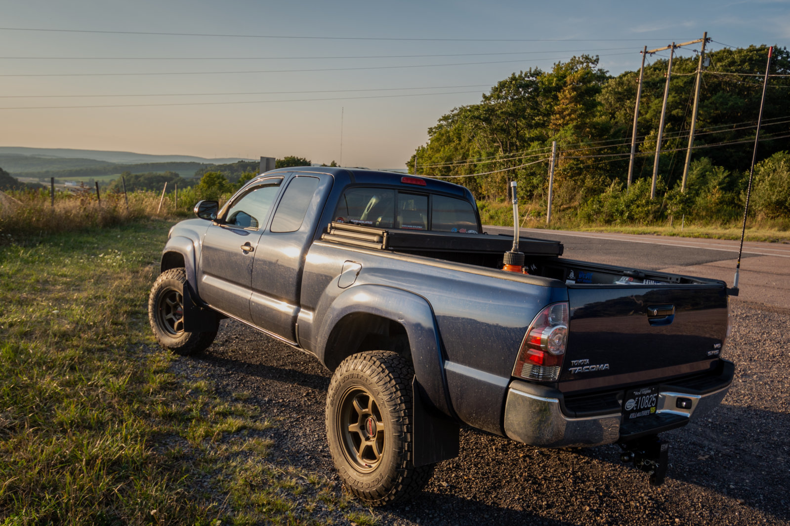

    Are you sure that you are not sitting at level 3? Stock is around 22" for a 3rd gen.
    24 3/4" is closer to the 2.6" that RXT advertises at level 3 unloaded. BTW RXT will come down over time too.
    All of the RXT's are shipped at level one. You take the 3rd leaf out and add the extra leaf in its place for level 2.
    For level 3, you keep all of the leafs and add the extra leaf into the pack.

    100% i got the packs new, swapped the leaf to put it to option 2 and my extra leaf with longer center bolt and hangers are sitting in my garage. I have had it them on for almost 2 years 15-20k and have always had 3-500lbs at all times, a few loaded to 7-1000lbs. It has dropped and settled since new but maybe 1/2'', i also have a 2.5 degree shim under the packs to deal with any vibration issues. That likely adds a little height but from what ive seen the access cab gets more lift from this pack vs the double cab. This picture has 5-600lbs in the bed option 2 with 5125's in the rear and 5100's at 1.1 in the front. Truck rides great, no noises, no vibrations, been very happy honestly hate to touch it but i was hoping it would have settled more.

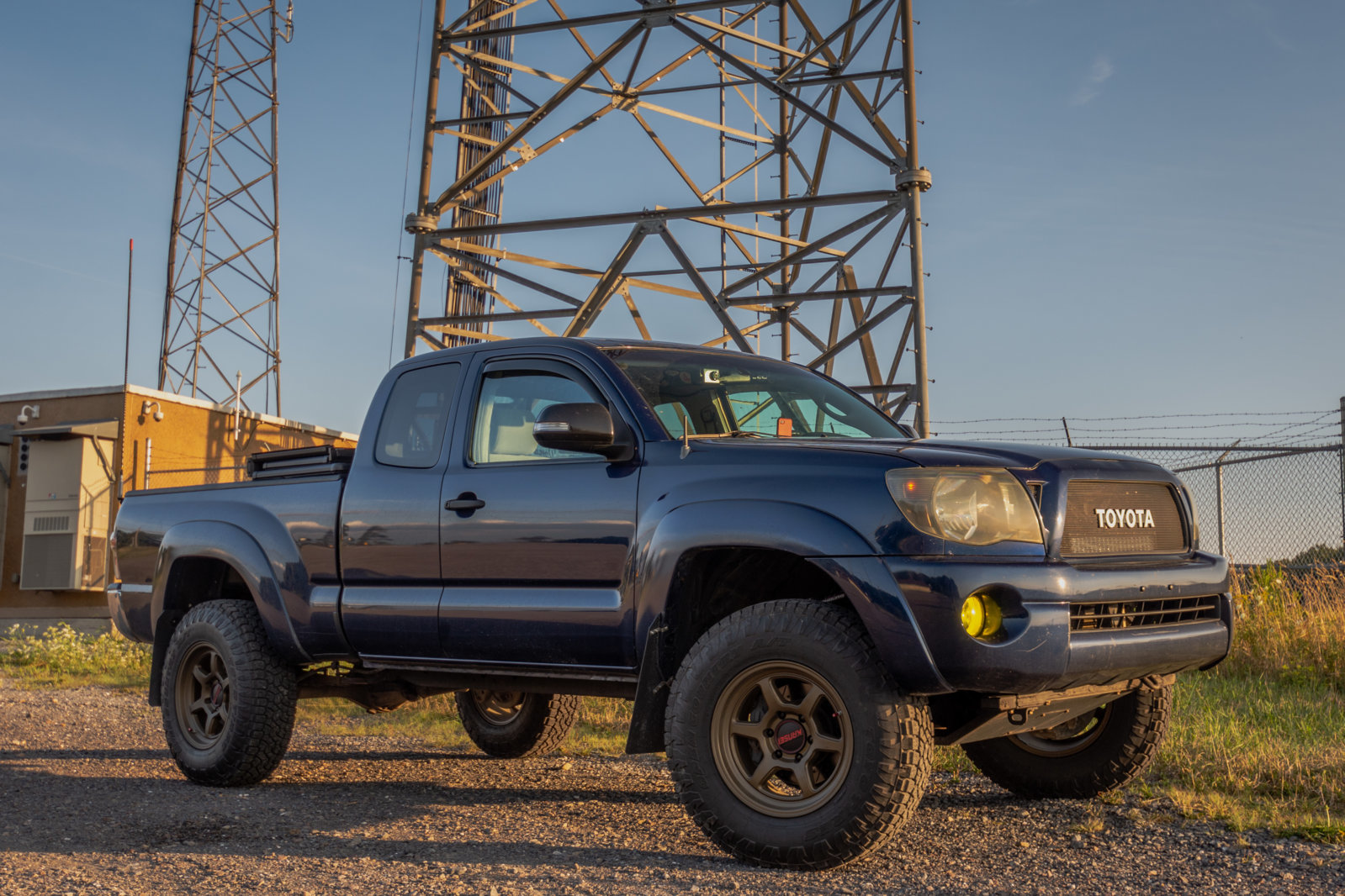

    im access cab too and even even after settling option 1 still gives me nearly 3" of lift. allthough like ive mentioned in here before my shocks give me almost an inch of lift themselves

    I have seen a few other pictures of your truck loaded with a quad or ski and it seems to hold the weight pretty good even being on option 1. Its what 100-150lbs difference between a AC and a DCSB, the AC gets more added lift than i would expect for the minor weight difference. Looks like youve since done a tire upgrade and cut the front fender looks beefy, being a 4 banger and an auto i need to be wise about tire size. Truck drives great with the 235/85/16s, re geared, lifted, and added weight plus decent mileage still 23-25 at 70. I would love a bigger tire to make it "look" better with option 2 but do not want to slow the truck down even more.

    yea i swapped the 33s for 35s and done the c4 fab front inner fenders. mines v6 manual so lower stock gears but going with 5.29s when i find someone that can swap them for me
