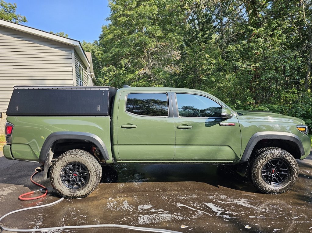

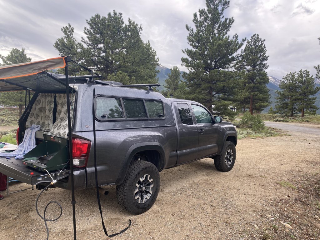

    As my truck sits right now with factory Fox pro shocks, option 2, 265/75r16, just my cap and a full tank of fuel my rear is at 39" measured in line with the center of the wheel. My cap isn't crazy heavy, I'd say roughly 150lbs. (front is Eibach TRD Pro lift springs if anyone is wondering)
    I'd say I lose about 1 inch when at roughly 500 lbs.
    Cap only.

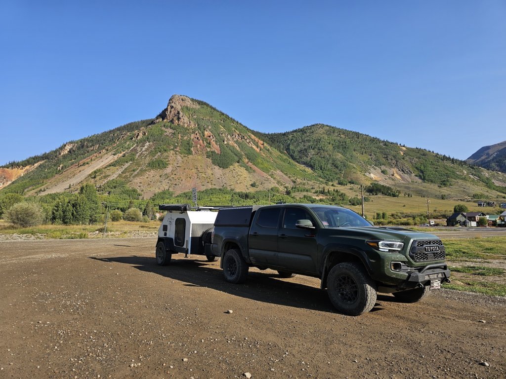

    Next is cap, gear, and tongue weight I'd estimate around 500lbs. Plus a full fuel tank as well.
    This is roughly 300lbs

    That looks great, from what I’ve read it seems you lose about 1/4” per 100 pounds though I doubt that’s linear. Any changes to rear shocks or brake lines?
    How much lift are you running on the front?

    No change to shocks or lines, just gotta move the brackets forward that hold the ebrake cable along the springs. Since I'm still running the factory Fox shocks the overall travel is the same, so the lines didn't need replacing. If you change to shocks that have longer travel than factory then you might need to look into longer lines.
    Front measures 36.75". I don't recall what it was before the lift. I would like another .75 - 1 inch in the front, but to keep the Fox shocks I'd have to run a spacer lift and I don't want to do that. Once these shocks need replacing I'll look at a proper kit.

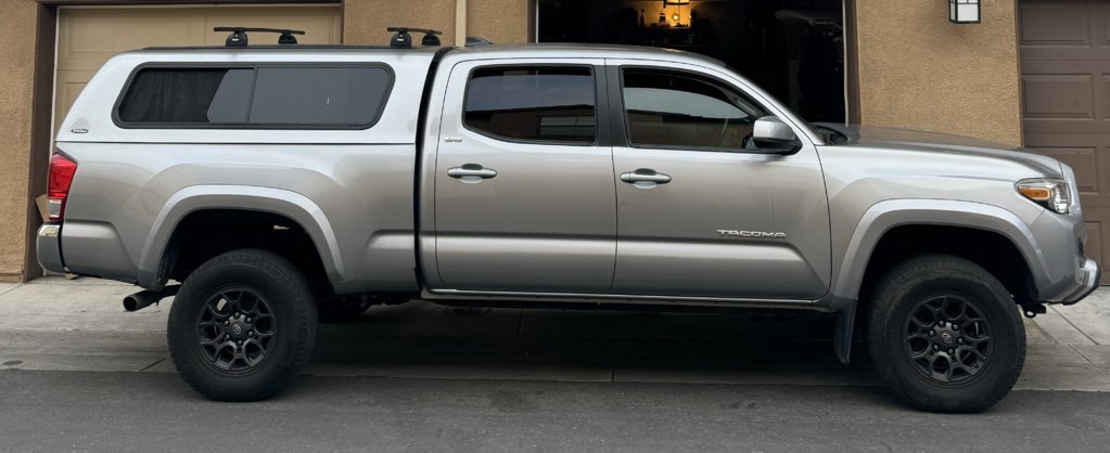

    Alright, figured I would chime in with actual measurements following install of option 2. I was hoping for 1.5” of lift with the topper and platform in the bed (actual was a 2.5” lift).
    I began replacing the front shocks as the oem shocks were garbage and making a clicking sound during suspension cycle. I opted for the 0.65 setting on the 5100s. I then took a look at my leaf springs and noticed they were sagging about an inch.
    Current hub to fender measurements:
    • Front: 21.5”
    • Rear: 24.5”
    Now trying to decide what to set the front shocks at since I’m sure the rear will settle but I would like to keep at least an inch of rake. How much rake is too much?? I imagine that could add wear.
    Only other loose end…
    • The brake line brackets still need to be cut off.

    Doesn’t look like too much take to me. I put my 5100 at 1.1 inch and have about 1inch of rake. I like it.
    Plus then you can load the truck down more with option 2 and not sage. Assuming you load it up regularly I would leave at option 2. It is a change that you just need to get used to. I thought mine was too much when I first put it on but now I’m used to it and love it.

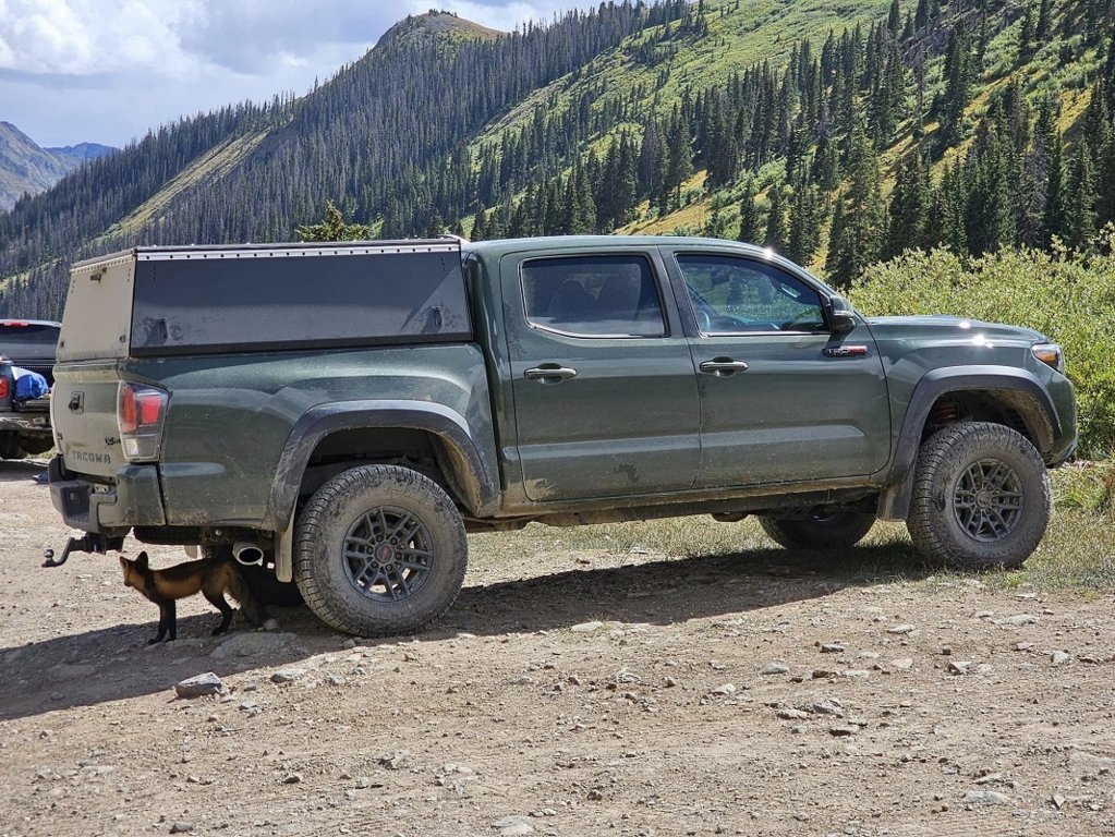

    Is that a totally random shot of a fox under your truck? Or was it snapped on the fly when you saw it? Or… do you have some weird dog breed that looks like a fox?

    This was at Animas Fork in Colorado. Theres fox everywhere because people feed them. This particular guy had some of the coolest coloring and I was I watching him for a while before he made his way under the truck to cool off in the shade.

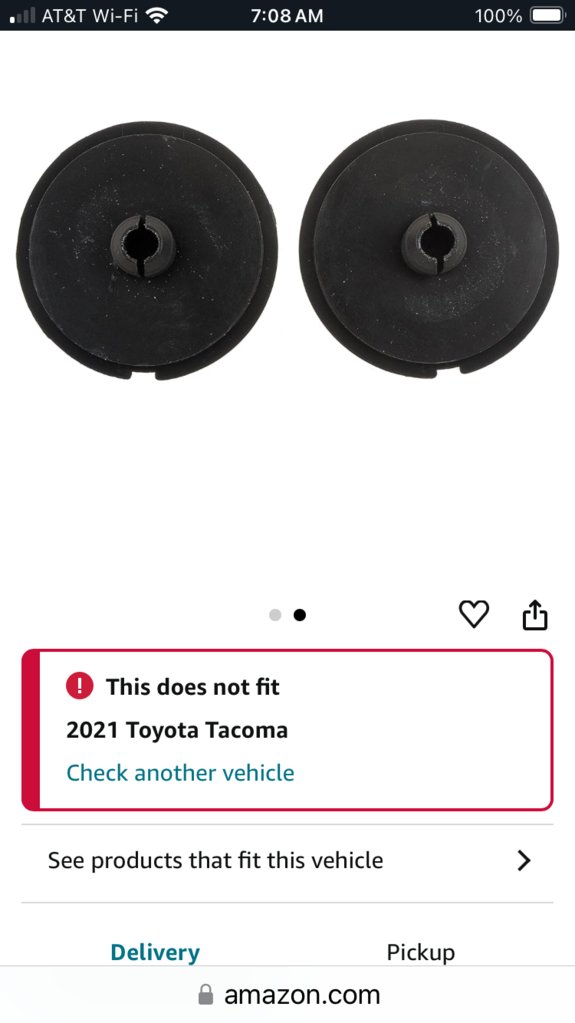

    Hey gang,
    I am getting leaf squeak ( pretty sure). Looking at changing out leaf separation pads. When I pull up Dorman pads, disclaimer says “Does not fit 2021 Tacoma”. Seems weird. Does anyone know why or have you successfully installed on 21 Tacoma?

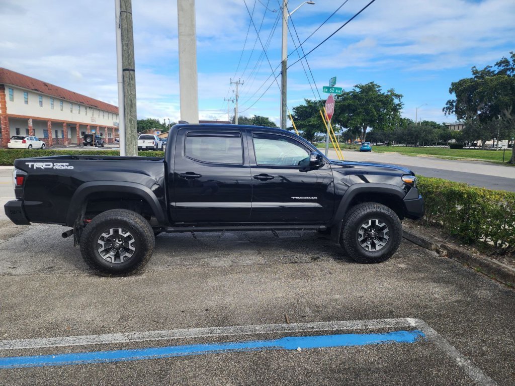

    Steelcraft Fortis front bumper, BodyArmor 4x4 rear bumper, LIft: Bilstein 5100+2885 OME coils, Icon RXT 3 stage. 255/85/16 wildpeak at4w
    Moved from Icon AAL +1.5" to RXT 3 setting
    • Front: 23”
    • Rear: 24.6”
    Rear additional weight - 110lbs - bumper.
    Front lifted with bilstein 5100 (1 setting) + OME 2885
    Front additional weight 150 lbs (bumper+ skid plate)
    Shaft angle 2.4.
    going to install shaft drop kit this week
