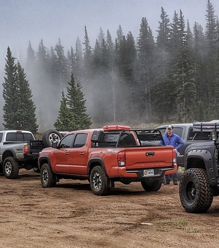

    Having my Icon Stage 9 kit installed on Thursday, thinking about changing out to option 2 before I take it in, I have this rack, boards and two dry cases mounted with basic socket set, screwdrivers, pliers in one and my Viair 88P in the other full time, then obviously more on the weekends when packed out with camping gear. What do y’all think? I will also have sliders and full RCI skids as soon as they are ready. Lol 27ECD1D3-F559-4A6A-9A0D-3757C2EC5DE1.jpg

    What do you have in the front? Option 2 will raise the back end like 2-3" or so I believe. The stuff you listed isn't too much weight really.

    Nothing in the front other than the RCI skids

    I have RCI aluminum skids, and Bamf sliders but no additional weight in the bed and I'm running option 1.

    Looks great! Looks pretty level and that’s what I like.

    Fender to center of hub measurements are Front 23" and Rear 23.5"

    Yeah until you throw a tent or a bunch more stuff on, or lift the front, I think you'd be stinkbugging with anything more than option 1
