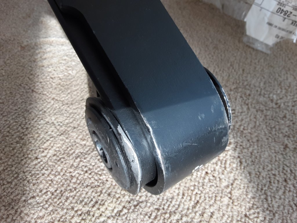

    Hey guys! Just received my new Icon RXT's, but 1 pack's damaged around bushing area on both ends. Should I install these anyway or send it2nd corner.jpg back for replacement?

    Damage looks catastrophic. Please ship them both to me. Will PM you my address.
    Kidding....
    Not saying it's right, but even IF you ship back and eat return cost, there is risk replacement gets same damage.
    Requesting or buying bushing outright and replacing yourself would honestly be the cheaper option.
    It's OK to be bummed parts aren't perfect, the alternative is leafs get shipped on pallet and shipping costs are 2x-5x what you paid.
    Damage on bushing sleeve should not impact anything from what I can tell in your photos.
    Polyurethane is not bulged or distorted in any way.
    Metal sleeve and leaf eye are press fit to not have any movement between interface so distortion on outer flange is irrelevant. Cosmetic only.

    That's what I was hoping to here. Thanks for the help!
