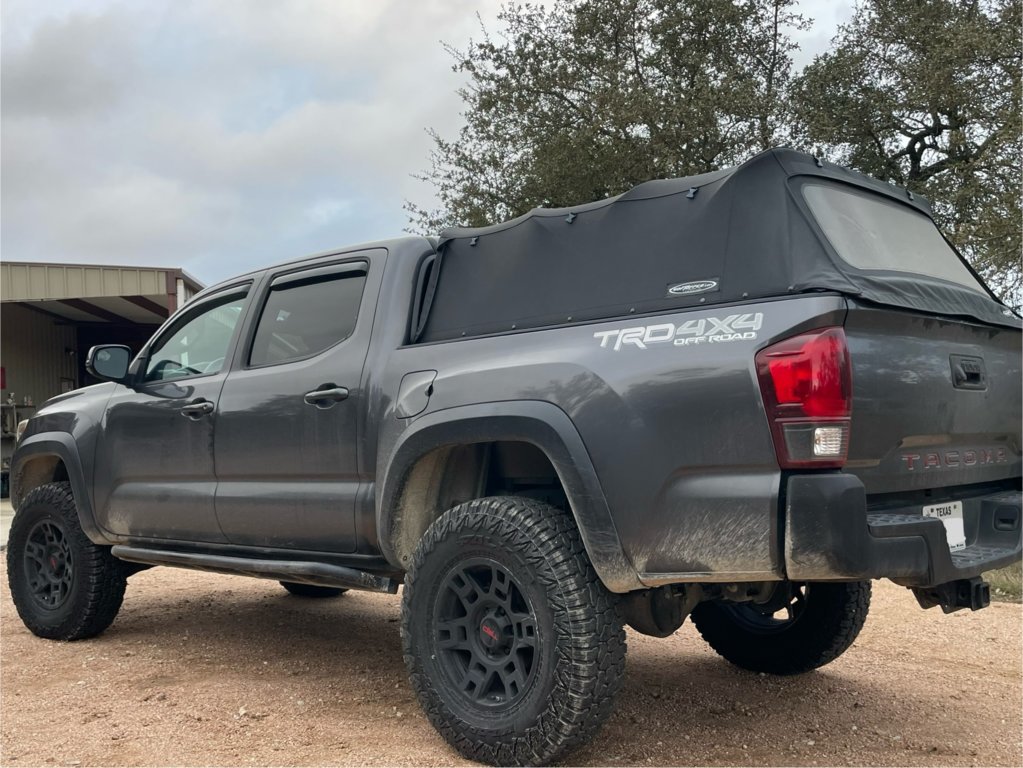

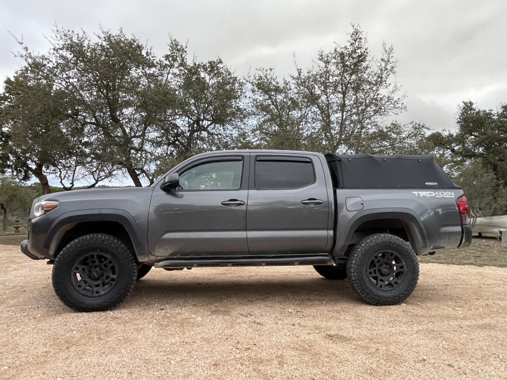

    Nothing really, just the softopper and bedmat so maybe 80 pounds? The RXTs are paired with eibach shocks, and 5100s with OME 887s up front and it rides great. My wife even mentioned how much better the truck feels now.

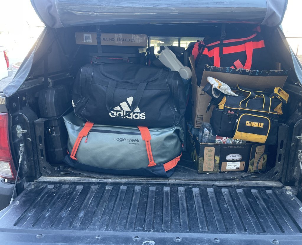

    A big reason for me going option 2 even though i dont have much constant weight back there….this is my wife packing light for a roadtrip—
    Im very happy with the RXTs, both loaded and unloaded

    …says the man with a Dewalt bag and tools stuffed in the corner.
    But necessary is necessary. :thumbsup::thumbsup::thumbsup:
