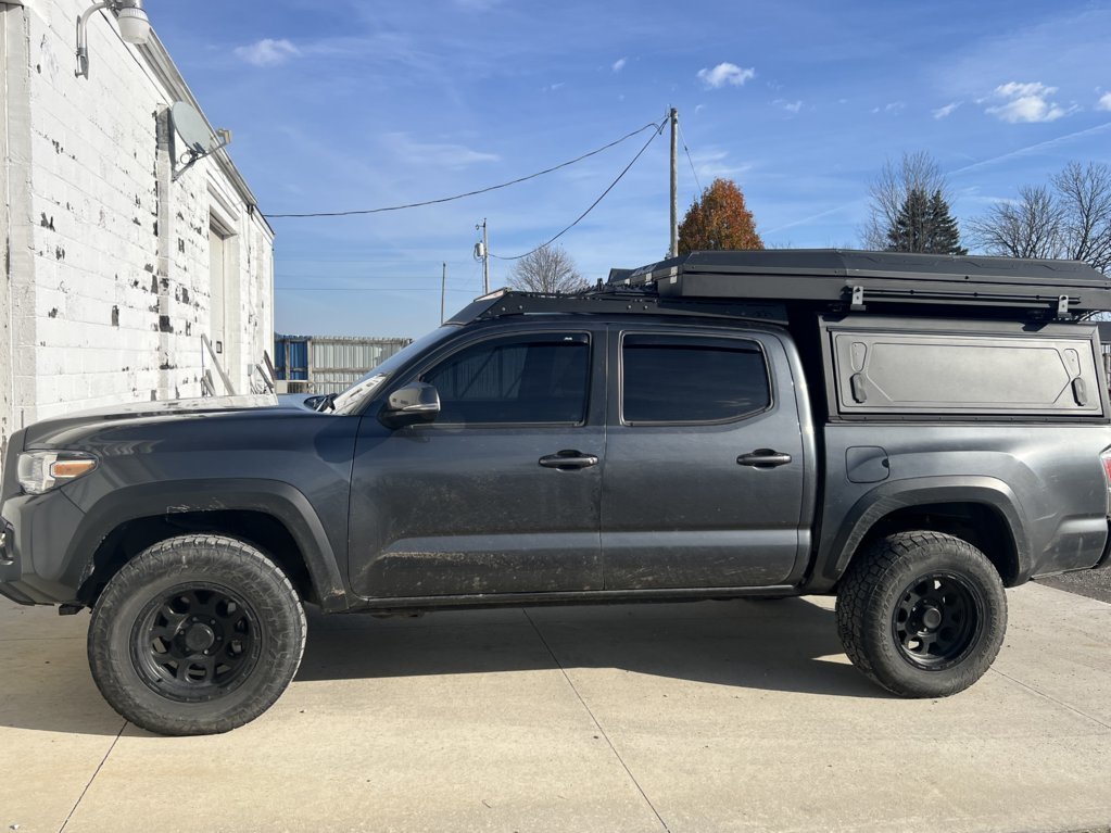

    Installed Hammer Hangers about a month ago. Significant ride improvement and helped my bounce some. Went up to option 2 yesterday and it rides even better. Sitting right at 1.5” lift with roughly 400lbs in the back. Still some bounce that annoys me but I’m thinking it’s my shocks at this point. I think the 2.0’s struggle to recover well with the weight I’m at, especially since they aren’t tuned.
    I emailed Accutune to see what they recommend, but I’m thinking I’ll upgrade to 2.5 Fox or King somewhat soon.

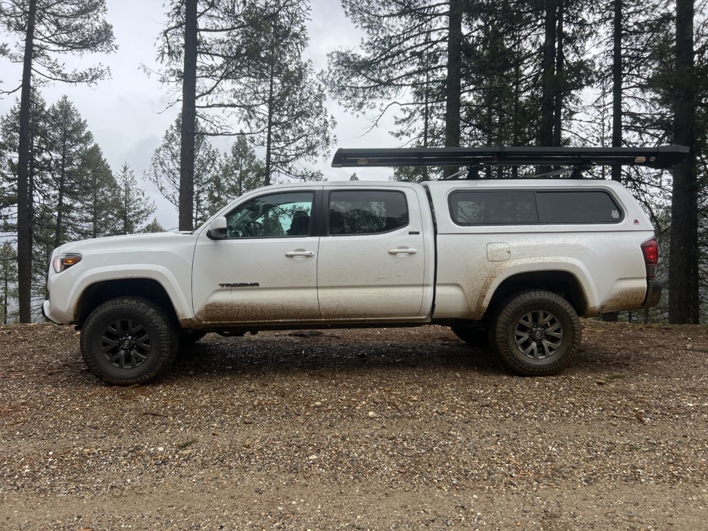

    option 2. Always loaded and tow a boat very often. Put 5100’s all around. Clip #4 on front suspension so says 1.5”. Didn’t measure before and after. Rides like a dream and no plans for 285s. I love my 265s.

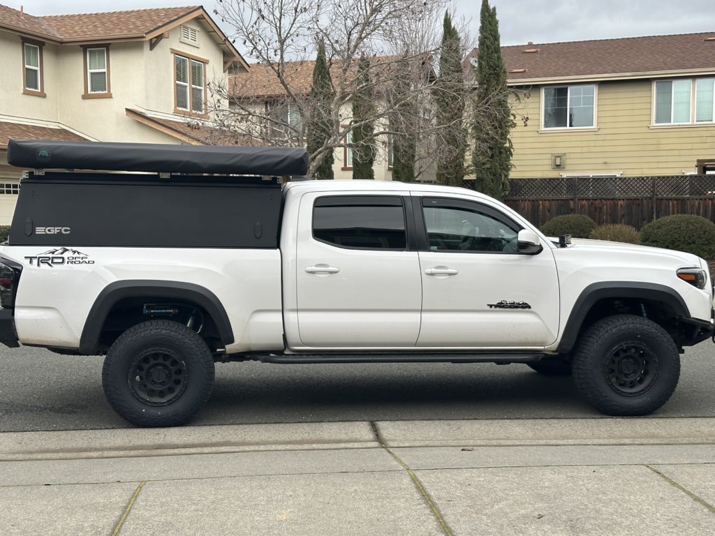

    option 3 for me still rolling strong . Also just went back to 265’s from 33’s. I’ll be sticking with my 265’s AT

    Looking good

    Looks good. New wheels too?
    Why the switch back?

    Thank you. I painted the wheels. Went through 2 sets of geo MT’s. Real quick. Radial pull after getting old. On road manners also just wanted a better ride on the street.Just got tired of the MT’s. I’m regeared to 4.88’s so it’s even better shedding weight. So far the Atw 4 are fantastic. Also CLoad so awesome.

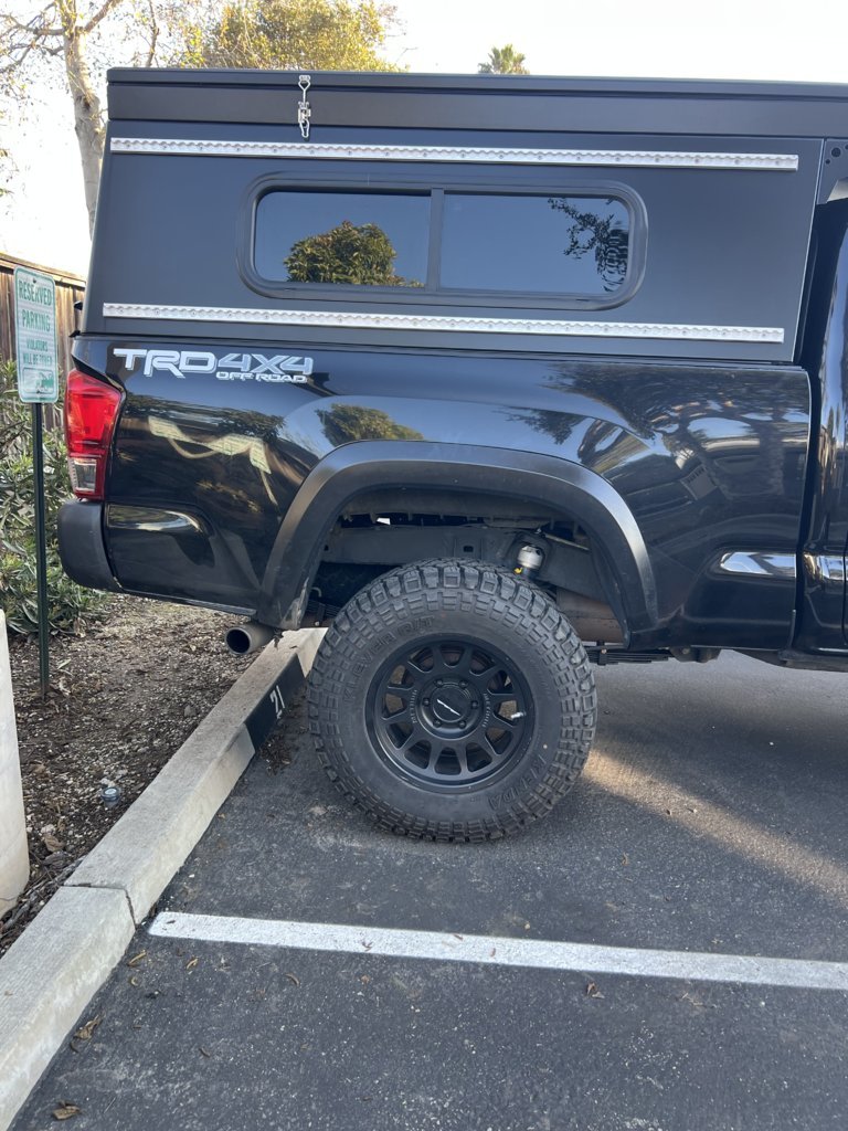

    Installed option 3 last night. Forgot to measure but certain gained *AT LEAST 1.5" in the rear because I had to let some air out of the rear tires to get out of the garage.:anonymous:
    Took it for a drive and it felt great not overly stiff and no vibrations on the freeway. This is with 400lbs in the bed, installing a drawer in the next few weeks so it might drop a pinch moreIMG_3496.jpg

    :cheers:
    Looks great

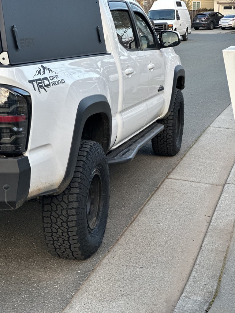

    IMG_4392.jpgOption #3 side view
