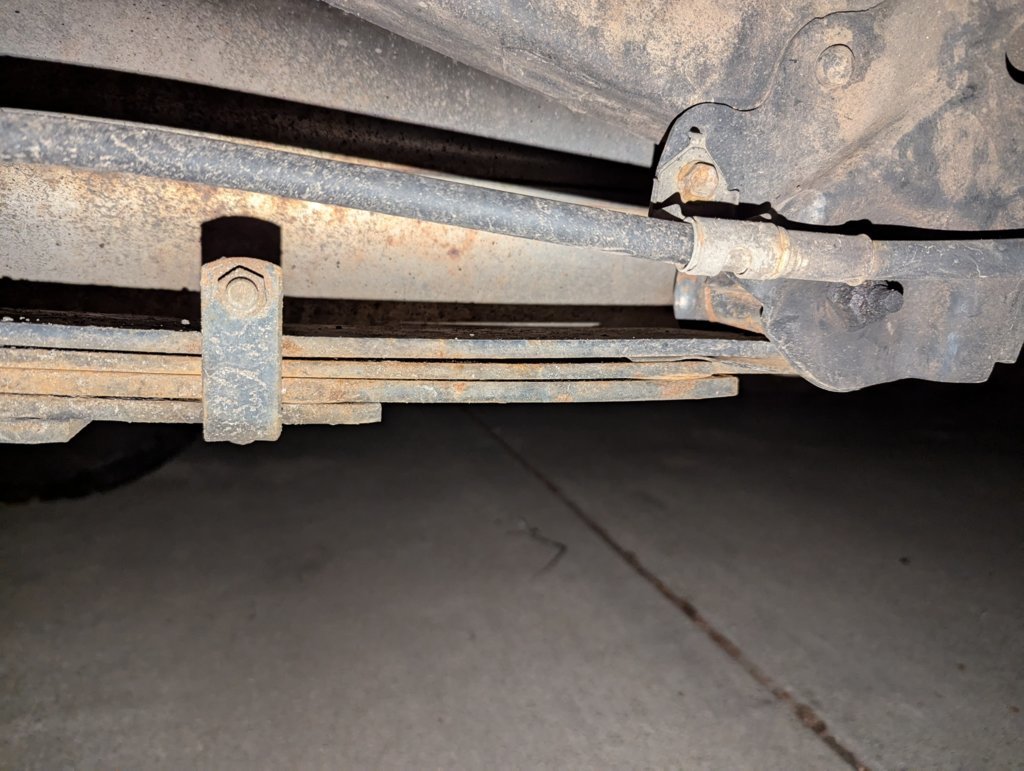

    Mine usually start squeaking after a long, fast dirt road drive.
    Make sure the leaves are all still in alignment and not rubbing against the clamps.
    And jack up the truck to unload the springs and pressure wash between them to get any stuck debris out from between them.
    Also while they are in the air use a prybar to spread the top 2 leaves and put some plastic or rubber between them, I used a chunk of old bicycle tube.
    I am at 3000 miles of no noise since doing that.
    You can see the bike tube near the mount, I have one on the other end too near the shackle.

    I have squeaking at about the same milage. I've noticed some misalignment of the leaves after a few trips desert trips. The misalignment I'll fix this weekend, for now the squeak isn't enough to bug me.

    did you remove the leaf pack to insert the bike tube or was jacking it up and the pry bar enough?

    Just lifting off the ground was enough. Once the springs are unloaded it was fairly easy to spread them.

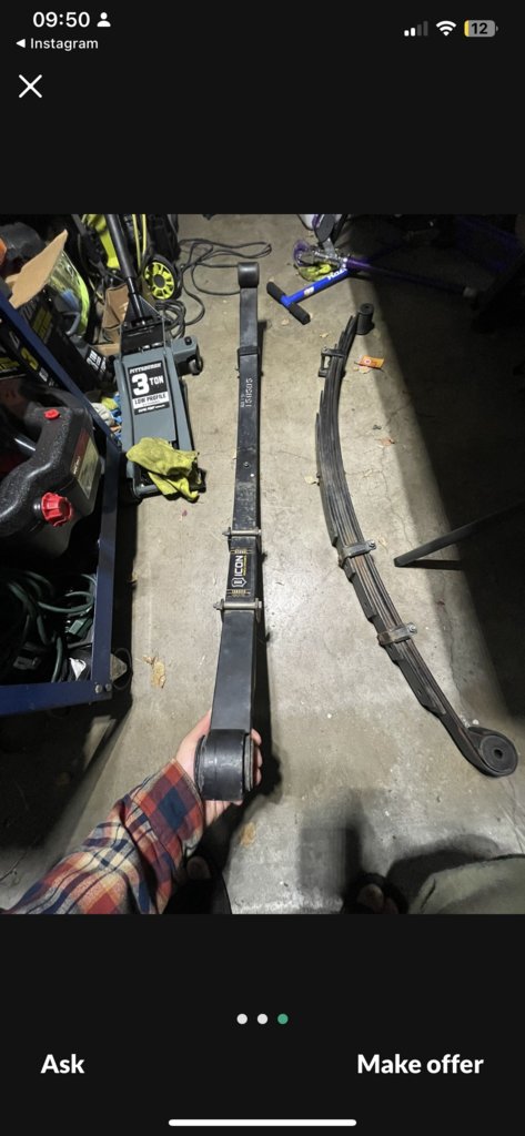

    I found a set online any way to tell what configuration they have set up?
  16. May 3, 2025 at 10:20 AM
    #2476
    TailHook
    TailHook Oh, what shall we do with a drunken sailor?
    Jun 23, 2018
    #257280
    2,900
    Alan
    Southern UT
    2018 TRDOR 4X4, 2007 Sequoia 4X4
    Those are set up on option 3...
    Easy to change them...remove the 4th leaf down for option 2, remove the 3rd leaf down for option 1.

    If you need to get rid of the option 3 leaf let me know. I have option 2 but with the extra weight I've added I'm looking to go to option 3
