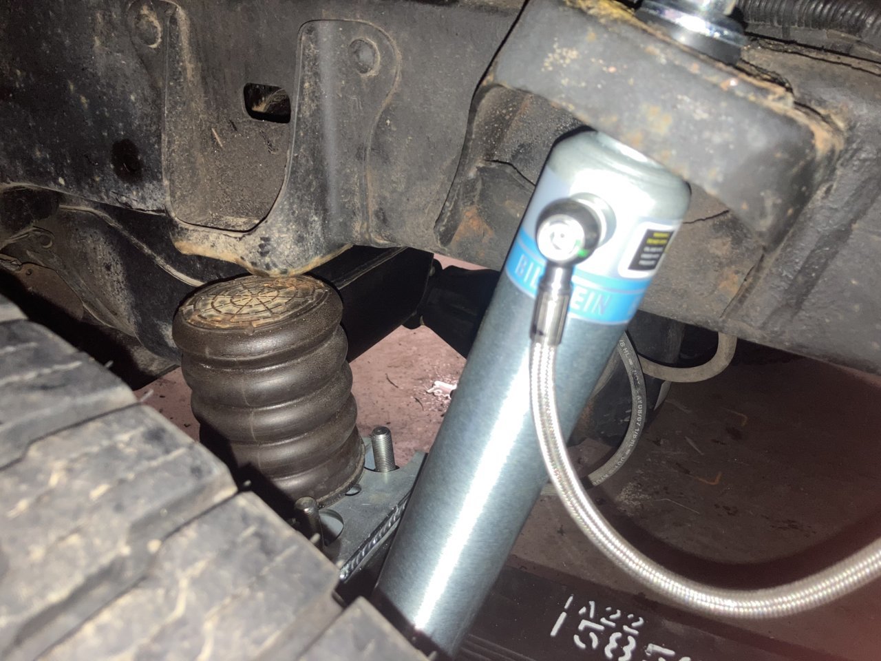

    I did 1500lb sumo springs instead of air bags and when I have constant weight, its not bad at all:
    Tronfunkblow and uhchxrlie like this.

    2020 MGM Tacoma SR SX Package
    So why would you recommend air bags and not sumo springs? Not a jab just a curiosity :boink::rofl:
    AR15xAR10[QUOTED] likes this.

    If you want ride comfort for 6 months on the road go air bags.
    if you want to be a hack like me and use sumo springs as extra overloads only when you’re towing or overloading the bed, then sumo springs may be the answer :anonymous: :oops:
  19. Jul 16, 2025 at 11:08 AM
    #2539
    AR15xAR10
    Apr 13, 2013
    #102024
    57,183
    2013 TRD Sport 4x4 V6 ACLBFTMFW
    Perfect reasoning. Air bags give ultimate control. Sumo springs are just a giant chunk of progressive rubber that gets stiffer the further down you push it. They are a little jolty and sharp for every day load carrying
    uhchxrlie likes this.
