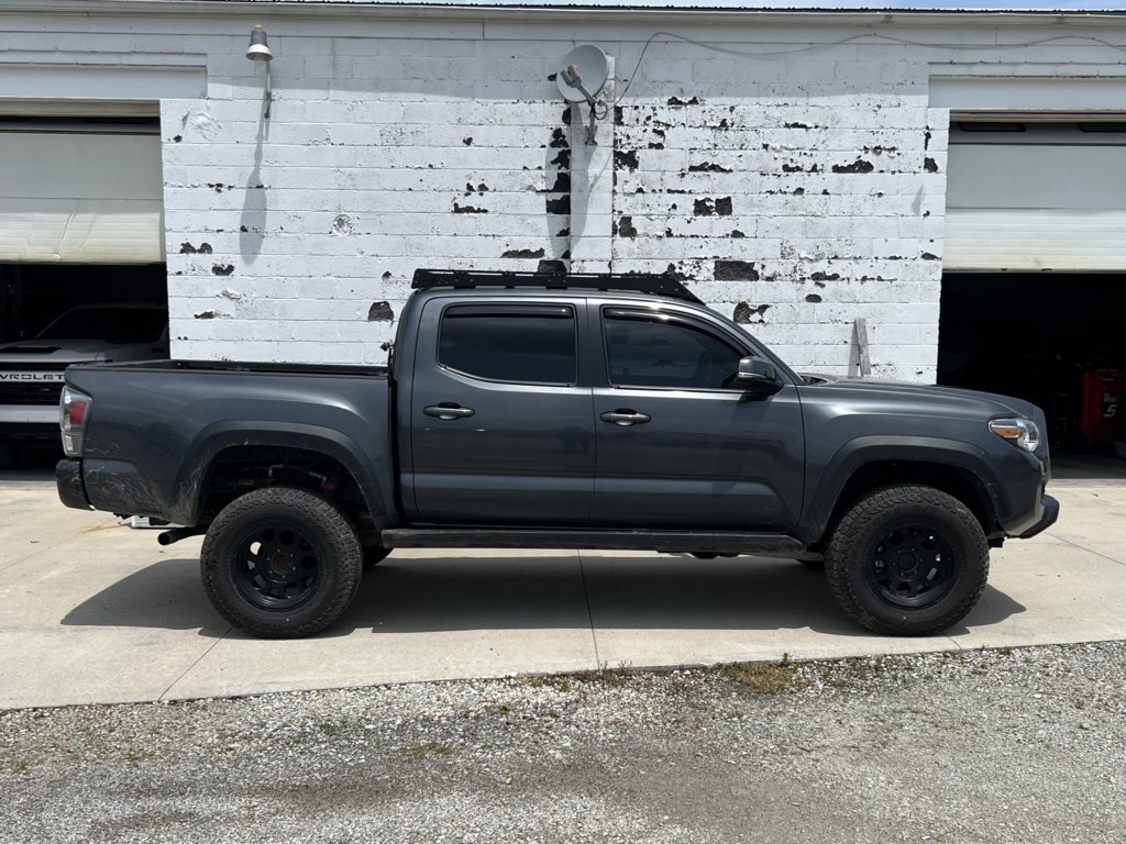

    stage two, with about about ~250-275 pounds (canopy + bed drawer build out). Personally glad I didn’t go full stage three, I am no longer bottoming out so much and the ride is much nicer. I think stage three might be a bit too harsh while not fully loaded with gear.
    FYI first pic is just with the new leaf pack and second is new leaf pack + ~1.5 inch front lift.IMG_6697.jpg IMG_6718.jpg
