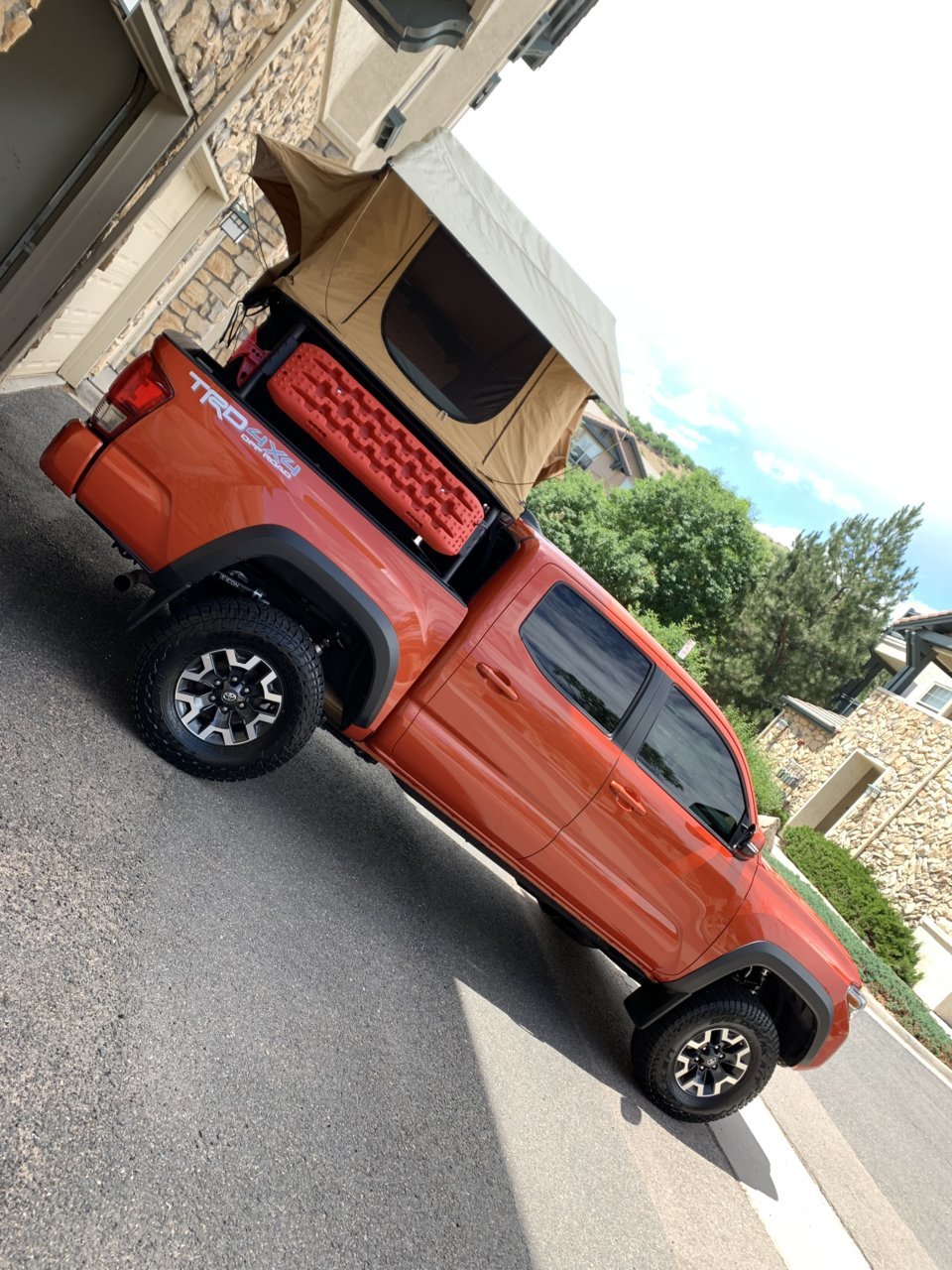

    Damn she looks sexy! What offset and tire combo are you running? Looking at doing the rxt's with 6112's up front and just curious what I'll be able to fit. This is on a 19 dcsb or.

    285/70/17 KO2's on 17x8.5 -10 SCS ray10's

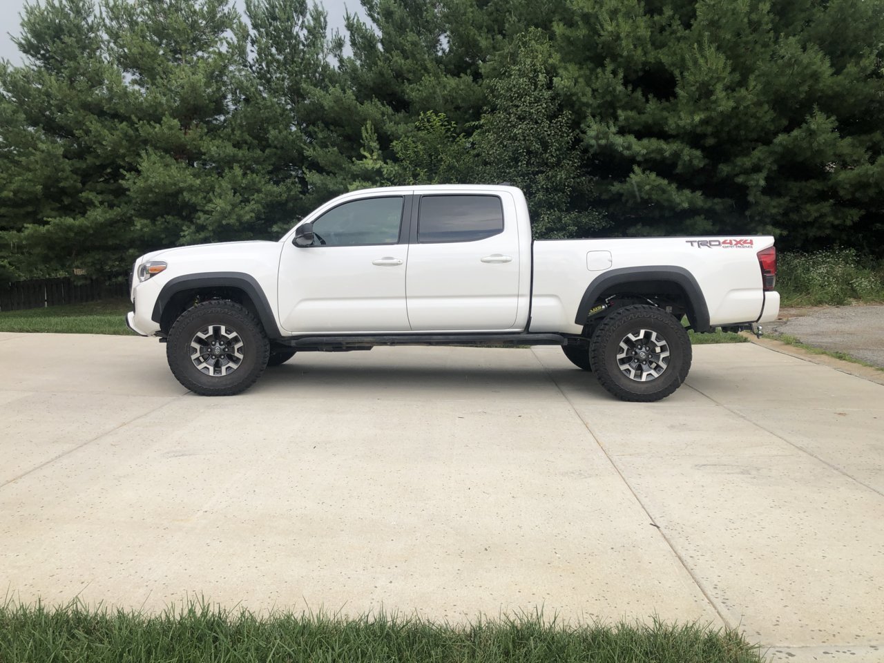

    Running option 2 on my RXT.
    Immediately after install the lift was 3” in the rear. I expect it to settle a bit.
    Obviously the front of the truck needs to come up, I’ll be adjusting it on Tuesday when I get toe plates to do a rough alignment afterward.
    Running ADS extended all around.
    The ride is good, better with a couple sand bags but totally livable without weight.

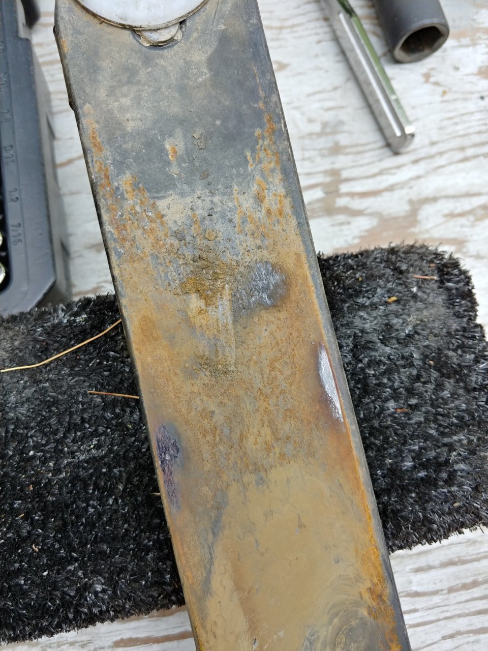

    This weekend I swapped down to option 1 (from #2). When I did I found some wear marks on some of the leafs. Looked like a few spots where they were riding metal on metal contact rather than on the isolator pads. Also, a shit ton of dust (as you would expect) that had been packed in between the leafs.
