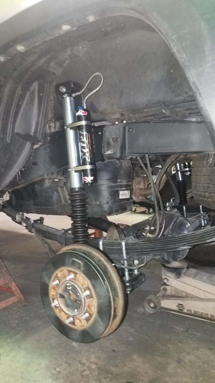

    this is with b110 that got 27.28” of down travel. Probably I can get more flex, but there aren’t any other shocks of such length that I can fit without cutting mounts.
    E0794C39-8B65-4D3E-BEFE-99F3478C5A04.jpg 12509555-C48A-4893-9C80-BFF64C9BE100.jpg
