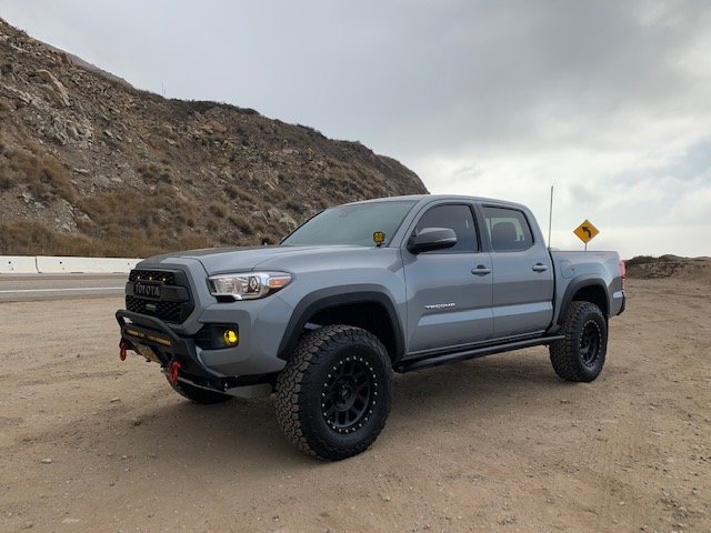

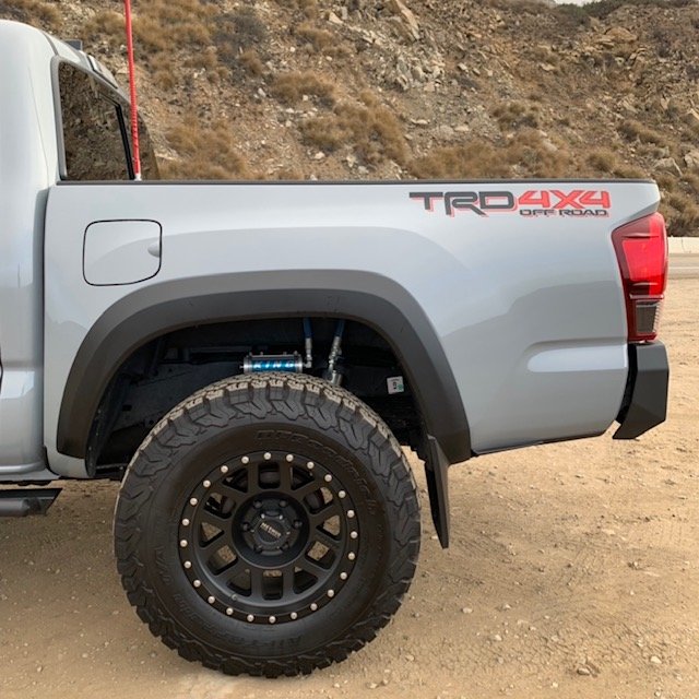

  11. Sep 6, 2019 at 11:02 AM
    #291
    justducs
    justducs VR40SIX
    Sep 20, 2018
    #266922
    57
    Josh
    Bentonville Arkansas
    2018 Toyota Tacoma TRD Off Road 4x4
  12. Sep 6, 2019 at 11:10 AM
    #292
    bunz559
    bunz559 Well-Known Member
    Jun 27, 2018
    #257678
    304
    Fresno, CA
    2018 Tacoma TRD Off-Road
    Would it be wrong to be more concerned about ride height than load if I'm 99.9% unloaded? I only intend to to lift my front 1.5 inches. I'm currently lifted 1 inch in the front leveling my truck out. Hoping to add another 1/2 inch or so. There aren't too many options of lifting the rear minimally without either going with a block or going super rake. What's everyone final measurements with option 1?
  13. Sep 6, 2019 at 11:30 AM
    #293
    justducs
    justducs VR40SIX
    Sep 20, 2018
    #266922
    57
    Josh
    According to Icon it is 1.875
    bunz559[QUOTED] likes this.
  14. Sep 6, 2019 at 11:33 AM
    #294
    justducs
    justducs VR40SIX
    Sep 20, 2018
    #266922
    57
    Josh
    and for perspective, my photo above your comment. I have 3" in the front and 1.875 in the rear. I feel the truck sits perfectly level like this.
